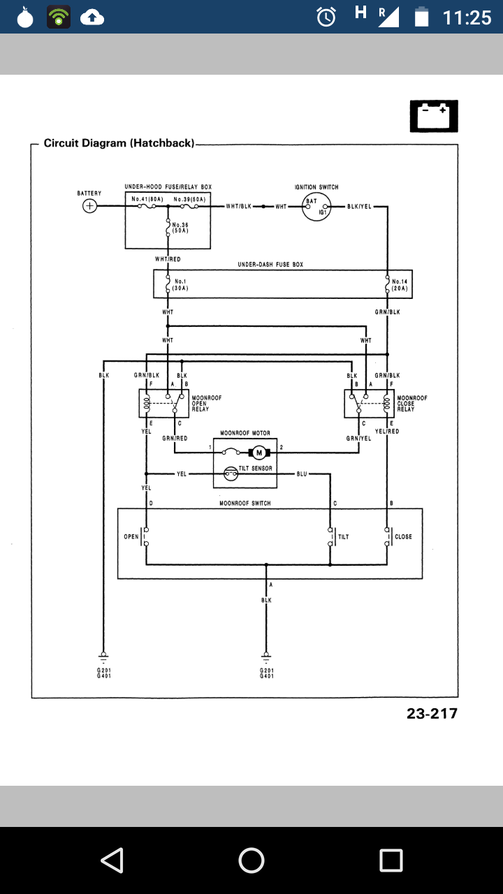

Wiring diagram shows one switch, 2 relays, 2 fuses, and the motor assembly. Plus wires of course.
If the black wire at the switch is missing the ground, use a jumper to supply a good ground circuit to it. (it grounds in the left kick panel area)

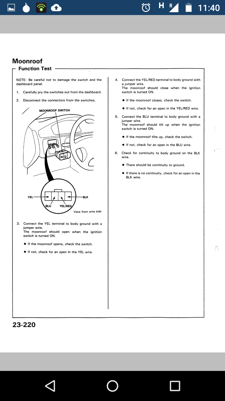

When I short the yellow wire at the switch, which should open the roof only ~ -250 mV measures at the motor connector. I have not checked the switch since it's not working even without it.
Originally Posted by GolNat
Do you have power making it to the sunroof motor connector when the switch is pressed? Did you ohm out the switch to make sure it is working?

Originally Posted by ezone
Sounds like whomever you bought it from either didn't diagnose it correctly or maybe more has gone wrong since it was checked, or he told you something that sounded easy.
Start at square one, diagnose and figure out what's really wrong.

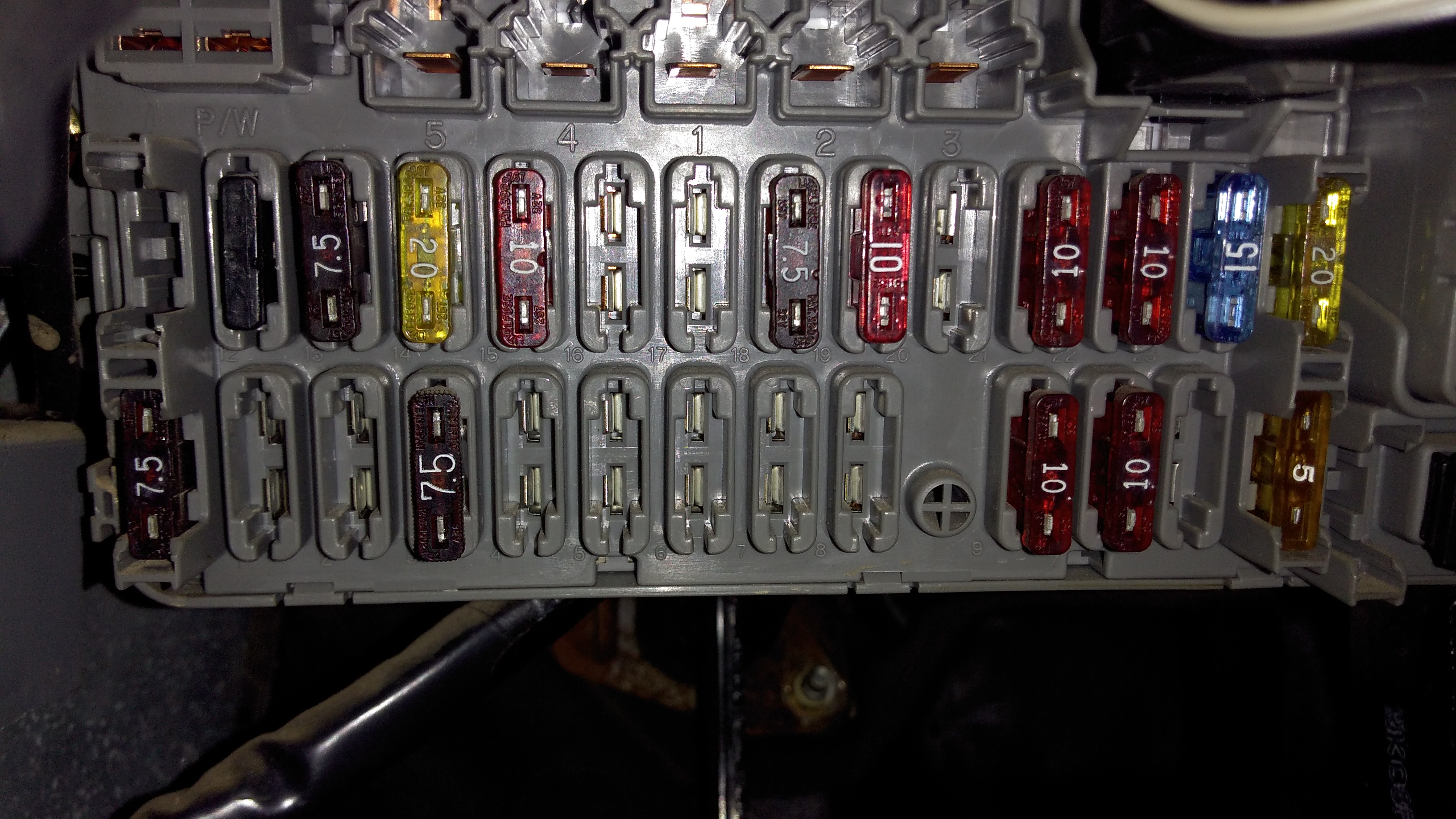

I think you're right. Looking at the underdash fuses the circuit diagram shows 30A in No.1, and 20A in No.2 and unless I'm misunderstanding the actual fuse box numbering No.1 is empty. I'll get a fuse for it today and report back perhaps with significant chagrin.

Alright, the excellent and only mechanic Drew here in Oak Creek, CO gave me a 30A fuse (he collects them from salvage whenever) mentioning "yeah the Honda tech who sold it to you probably probably kept blowing the 30A every time he tried to use the moonroof switch and so just left it out and figured the motor was blown." So all is good and back together working better than before and since I didn't want to risk blowing the fuse to test the old motor are there any ideas how to test the old motor to characterize it as "blown" and why? Thanks for your attention thus far and cheers!
