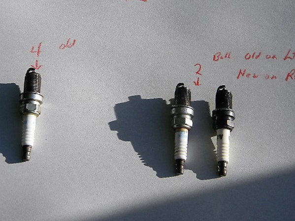

Got pics of the plugs you pulled out?

I'm not seeing any pics here.....

heres pics of clyinder 2 old that was misfiring and new plug that was misfiring,, and cylinder 4 old plug that was weak,,

Can you get any closer to the important part?

Mine look like 3rd and 4th pics. 2nd cylinder is like oil fouled, and 4th is like cross of 1 and 3,
