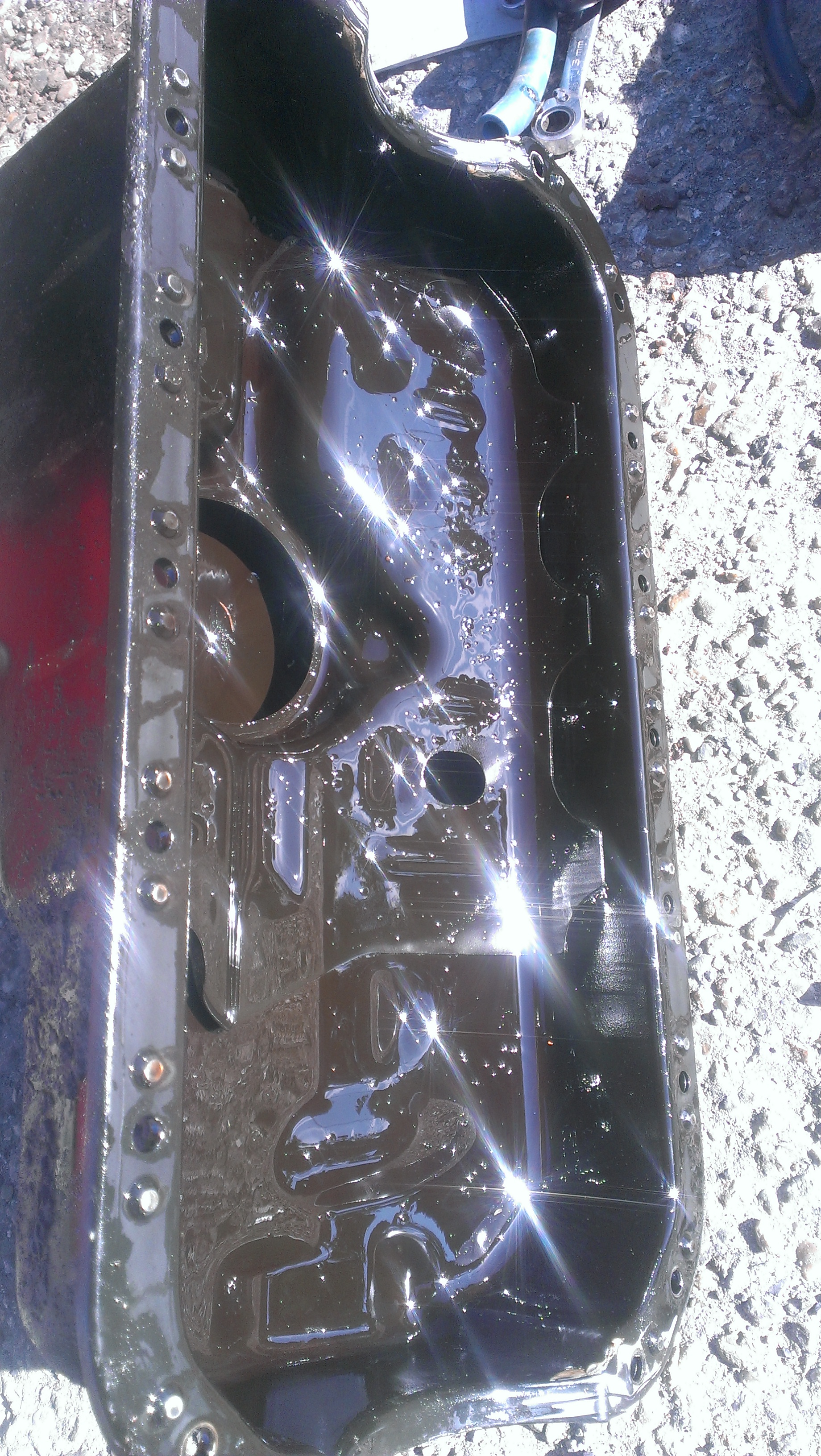

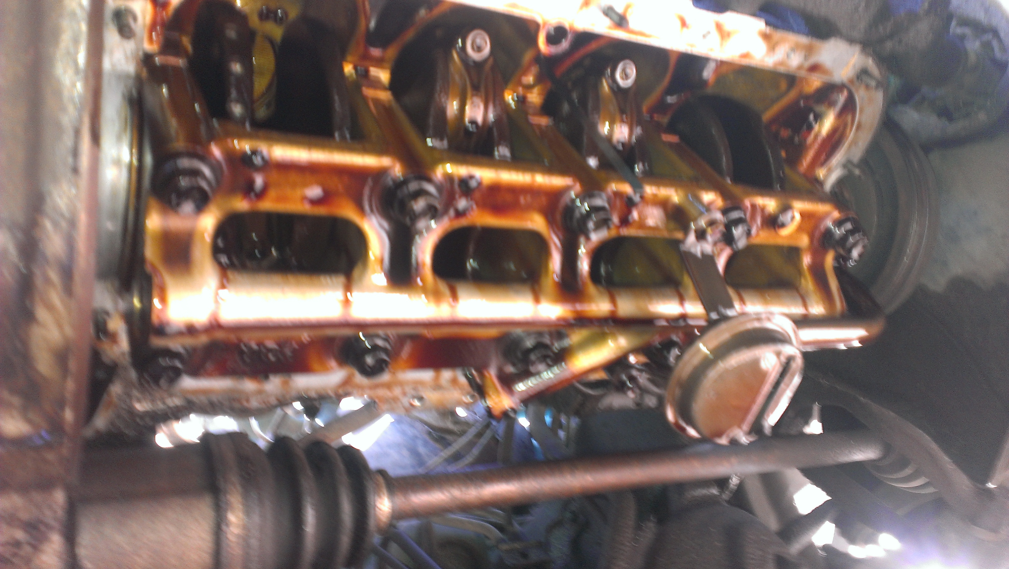

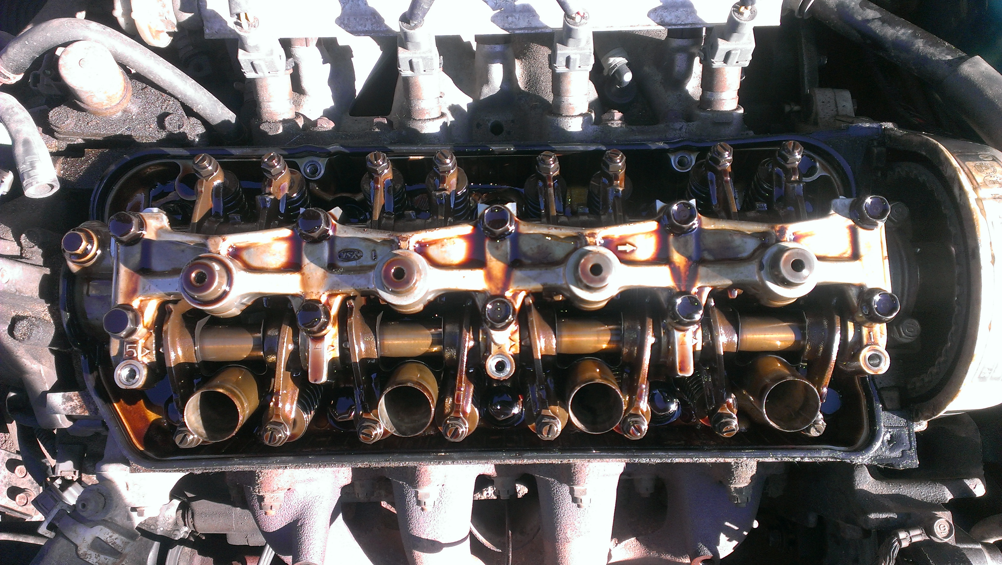

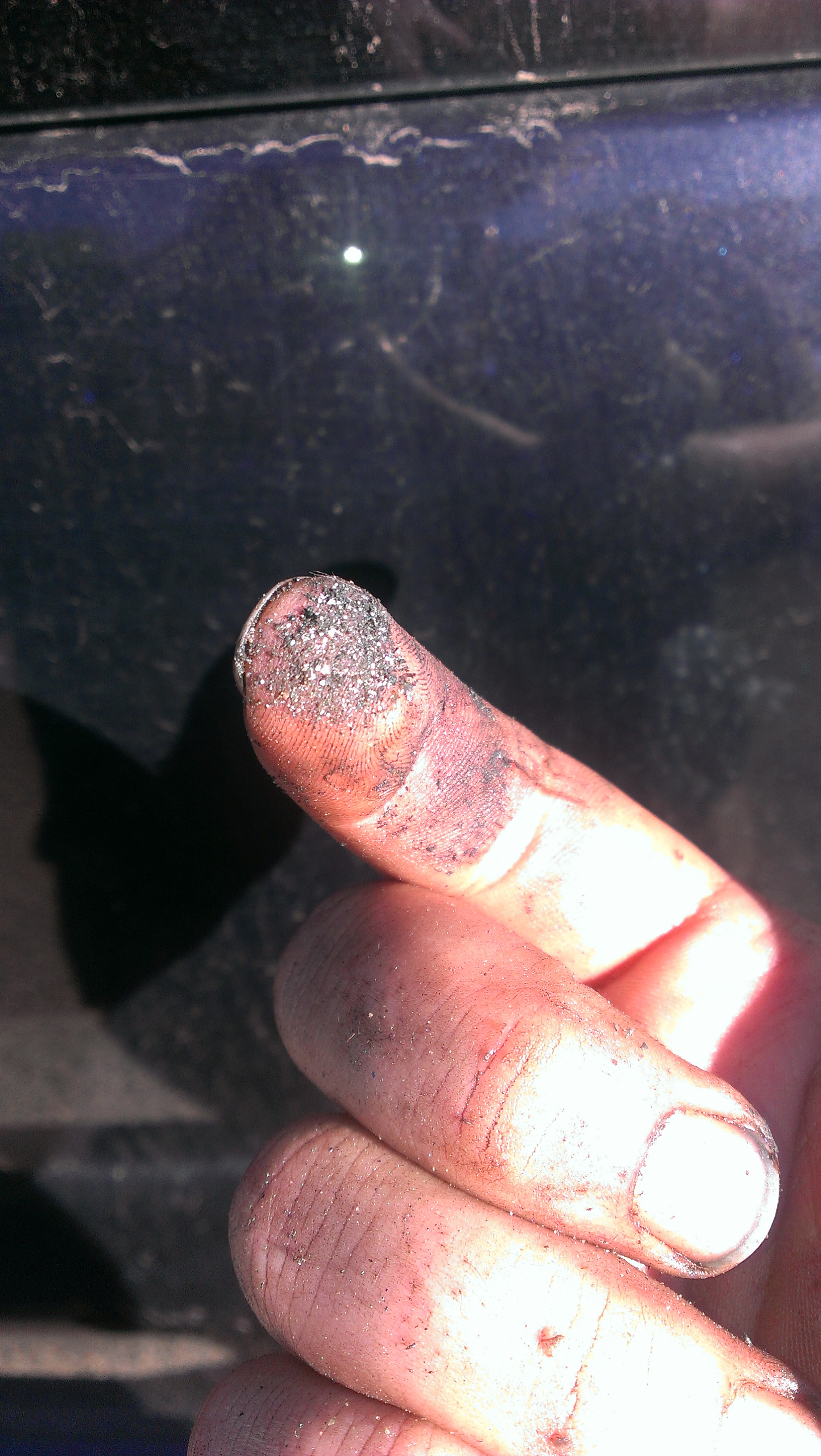

okay so i have the everything exposed and ill try to best explain my findings, and possibly attach photos if i can figure that out. i drained the oil and removed the pan, in the bottom of the pan i found what looks to be either sand or crushed glass (no idea what it actually is thats just what it looks like) as well as some metal shavings about the size of a fingernail clipping and a dead wasp. (both how that got in there and stayed in there when i did an oil flush and change when i bought the car i dont know) under the valve cover there was hardly any oil (i have no idea how much should normally be in there but im sure its more than there was) and under the timing cover there was tons of metal shavings about the size of glitter. just trying to crack the main pully bolt loose with the belts still on (im currently working on getting the bottom potion of the timing belt cover off to do all the marking before i take off the timing belt) i noticed the bottom end will move a little and the belt pulls tight but the cam doesnt budge at all. could that be a bad cam bearing? would explain the grinding noise. ive yet to get the pump itself off. but to me it looks like ill be needing major work or just a new engine

well i pulled more stuff apart, theres so much internal damage every issues its ever had is fully explained now. im goin to have to get another engine for it, and budget limitations mean wreak yard.. thanks to all who took the time to read this and give advice its much appreciated

That alone is very bad. Your engine apparently was going downhill for a while, but now that engine is a goner.
The idiot light is also known as the "TOO LATE" light.
The pressurized oiling system must be able to maintain (hydraulic) pressure in order to keep the bearings from destroying themselves with metal to metal contact.
General rule of thumb is 10 PSI for every 1000 RPM, and if your oil light comes on that means the pressure dropped below ....roughly 5 PSI is where the switch turns the light on.
That "sand" is metal. That's the destroyed bearings.
Good luck
