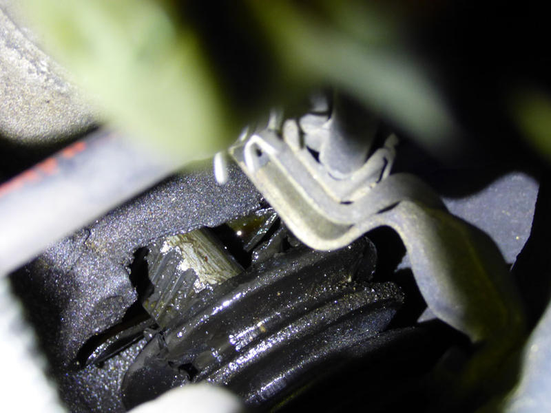

So the dust boot on my tie rod (drivers side) ripped open.
It seems to be leaking grease of some type quite heavily.
Can this be rebooted with a 2 piece boot while on the car, or will I need to pull the tie rid out and use a one piece boot?
If I have to pull it, is it a fairly easy job or am I going to have to rip out most of the suspension to get to it?
94 dx auto.

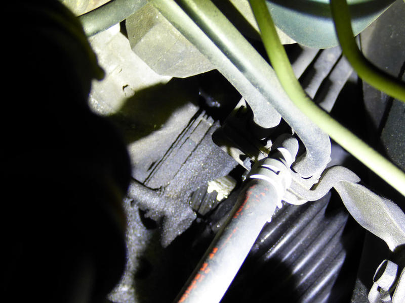

It's called the Tie Rod Dust boot. I think the grease is actually power steering fluid and that the rack seal is blown. So I will probably have to pull it all out to get to the seal on the rack.

I was thinking you were referring to the simple end at the wheel. That is what was a bear for me to fix on my 94. That is power steering fluid that has leaked by the seal from the inside of the shaft with the gear rack. Mine boot had a lot in it. However after cleaning it all up, I ran the motor and did a lot of steering it and it did not drip. So I just replace the bellow dust boots. I think a little weep over many years is not a real leak if it does not drip. However, if you turn it stop to stop and it leaks under pressure as a drip, probably need a rebuilt steering rack. I may just have the drive shaft on my 94 mixed up with this. Not sure why this would be a problem other then popping the tie rod taper out of the knuckle. If you do it, be careful not to tear up it's boot. Some generic tools will. Think I put pressure on loosened nut and tapped the side with a ball peen hammer and it popped out. Be careful to keep count of length so you do not screw up toe in alignment.

Ok first evaluate if there is really a leak that needs addressed.
Is it or has it been losing PS fluid with no obvious visible external leaks?
There will be some amount of grease found in the rack boots just because the rack gear and pinion gear have heavy grease on them from the factory....that's the only thing that lubes those moving parts for their entire lives....PS fluid does not lube the heavy parts of the rack.
PS fluid stays thin, it does not thicken......and there may be some accumulation of any PS fluid that has seeped over the last 20+ years.
If there isn't and has not been a significant loss of PS fluid, I may just reboot the rack (if it hasn't collected a bunch of debris in the torn boot area), and then do a wheel alignment on it since the tie rod ends have to be removed to change the boots.
I have never heard of 2 piece rack boots.
You would need a pair of rack boots and the set of 4 clamps, maybe clamps for the small balance tube if equipped.
Sometimes the small clamps can be reused, but the large boot clamps usually need replaced to do the job.
If there IS a significant PS fluid leak, I might slap another rack in it.
Replacement is far quicker than DIY rebuild, and gives better results with far less liability in the shop.
HTH

I just added power steering fluid for the first time. It was towards the low mark. It seems to be leaking bad enough to leave a few drops per day in the garage. This I believe is fairly recent. There is a decent amount of grease on the upper arm below the tie rod boot. Pretty thick and nasty. That seems to have been there for a while as the boot tore a few months ago.

Replacement or rebuild or reboot or whatever is up to you...
Replacement may be the safest bet since you say it's been open for a while. Steering is a pretty handy thing on cars these days...

Since this is a safety issue, I will replace the rack. Whether I keep the car or sell it, I think it really needs to be replaced.
