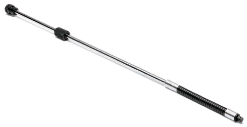

Air ratchet and flex socket?
Erm... 1/4"drive flexible carb adjusting tool?
I actually still have one of these LOL, it was my very first purchase from the Snappy tool truck.
Every once in a while it still comes in handy for something.
