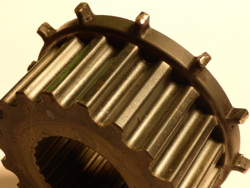

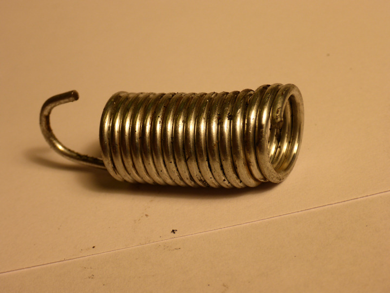

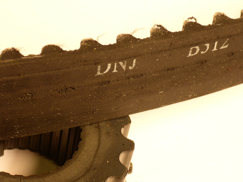

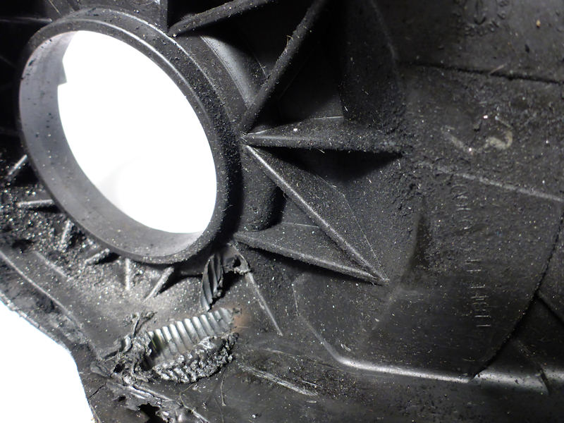

What he found was the brand new DNJ tensioner spring jammed into the bottom of the timing belt cover. With less than 600 miles on it the spring had broke off and bounced around down inside the timing belt cover:

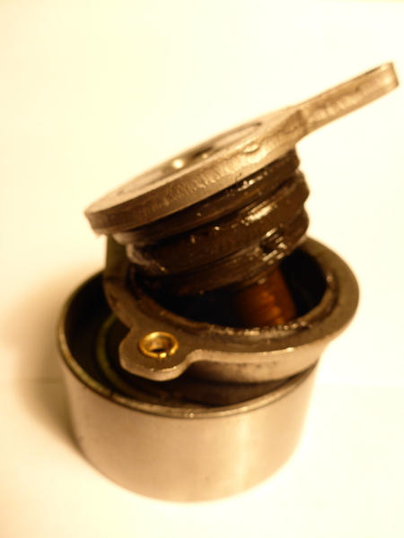

when he removed the bolt from the tensioner it fell apart
