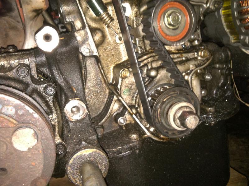

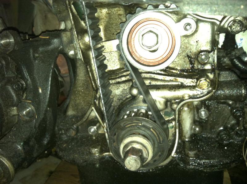

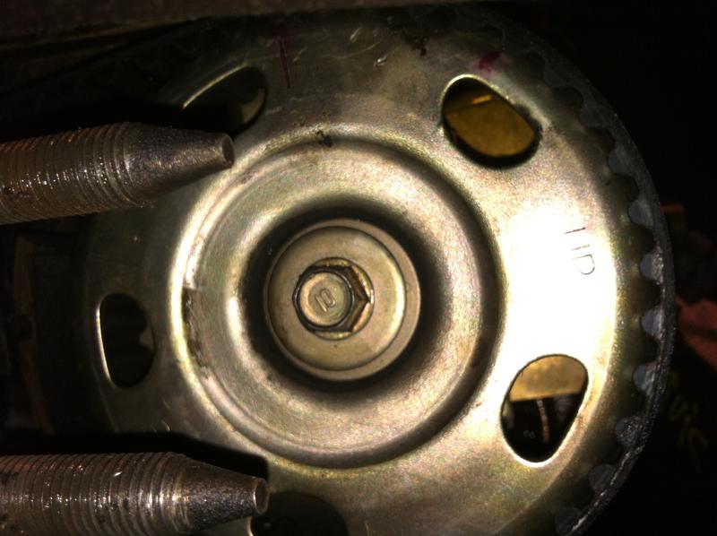

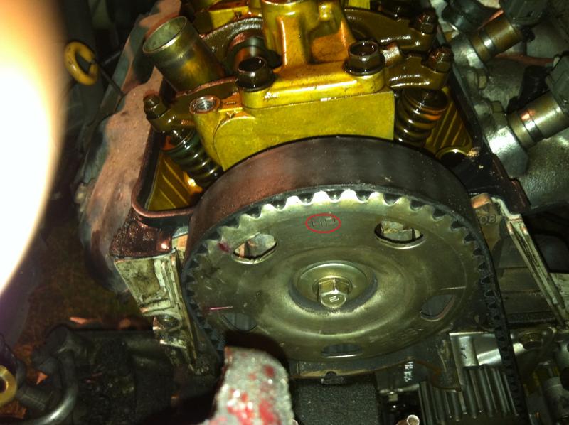

Hey guys, i really do hate to start out with a question, but i guess i have to. I bought a 94 Civic ex (i think, could be a dx) either way, its a 4-door with the 1.6 vtec in it. When a bought it, i thought for sure it had just jumped timing and i would be driving it that afternoon. Of course i wasnt nearly that lucky. I will post some pics if i can, but when i lined up all the timing marks (after removing all the wonderful bs it takes to get the timing covers off) they all ine up perfect. I havent found a pic of a timing mark on here or google that looks anything like mine, so i just put #1 cylinder at top dead center and the cam gear show the "up" right and the top and the other marks line up as well.

ps, in the kast pic, i circled the "up" on the cam gear

i meant ignition timing, not cam timing. you need a timing gun i believe to check the ignition timing and set by moving the distributor. for cam timing, there are marks on the crank pulley and UP on the cam pulley.
