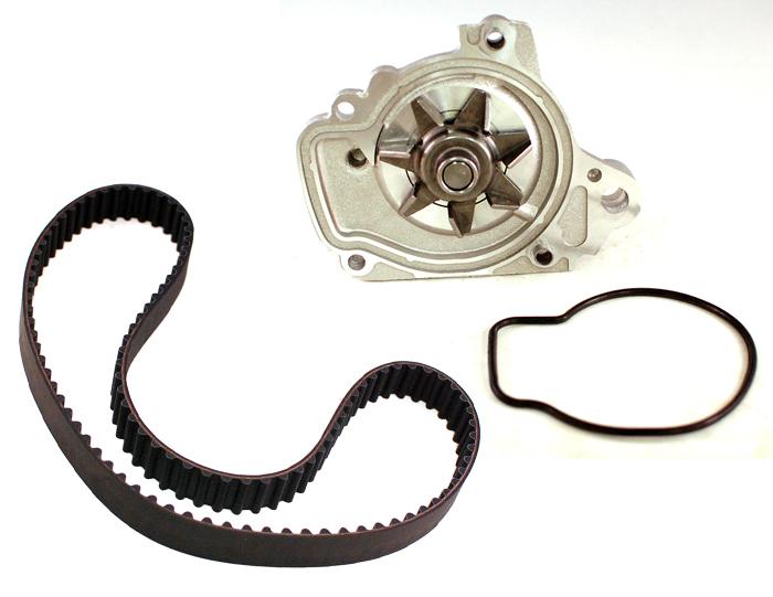

Fins, i guess that's how I describe them. They push the water through the cooling system. If they are corroded you will have trouble.
You can see them in that picture. Pop the rad cap when the car is cold, start it up.. top it up with coolant until the rad is full.. let it get to operating temperature and watch the coolant, is it circulating? It will not circulate until it gets to optimal running temperature. If the level drops while your watching it keep filling it up.

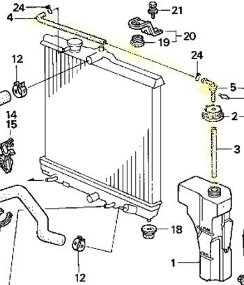

Are you missing part #3 in the picture (click for larger)? This would cause your coolant system to draw air from the overflow tank instead of coolant, leaving not enough coolant in the system. Did you unscrew the radiator cap (only when radiator is cool) to check the coolant level like BlueEM2 suggested? Was the coolant up to the top?
Does anyone here know if it's bad to mix different kinds of coolant? If so the red coolant should be replaced with green. (It's not hard to do because the coolant tank just pulls out- the tricky part is discarding the hazardous coolant safely.)

I have a 93 civic; same generation as yours. On mine the radiator fan only switches on after the car has been running for a while. (My AC is broken so the condenser fan doesn't turn on at all.)
Originally Posted by deatheragel84
it was my understanding that when the car heats up the cap is supposed to push the hot water into the overflow and pull colder water in through the cars cooling system to help maintain the temp that is how it was explained to me cus like i keep saying im dumb about this stuff but im trying to understand so i am not so ignorant about my own car
The hot water flows into your radiator through the fat hose at the top. It cools off as it flows through the radiator. Then it flows back into your engine through the fat hose at the bottom. That's how your engine stays cool.
When the engine is warm the coolant expands and takes up more space than it did when the car was turned off. The plastic reservoir gives it a place to expand to. So as the car is warming up and the water is expanding, some of it should flow into the reservoir and you should see the level in the reservoir rise a little. (Then when you turn off the car and the engine cools down, some of the coolant should get sucked back into the radiator.) That's how the coolant stays at a constant pressure when the engine warms up.
Hose #3 in the picture is a little hose hanging down from the plastic reservoir cap; its tip should be submerged in the coolant. You might not see this hose unless you unscrew the reservoir cap.
when the water heats up it has no where to go so is building up pressure in the engine
Still sounds like you might have a clog between the radiator neck and the overflow reservoir. Test this as follows: 1) Remove the coolant reservoir cap (with the hoses still attached to it) and the radiator cap. 2) Try to squeeze air through the end of the hose by cinching a partly inflated plastic bag around the hose end and squeezing the bag. 3) Look into the hole where the radiator cap was while you squeeze the air. You should see coolant or air sputtering into the radiator where the overflow hose attaches to the radiator neck. If the overflow hose is clogged that may indicate that other parts of your system are clogged too.
Note: coolant is toxic- never put your mouth on a hose, and wash your hands after handling coolant.
