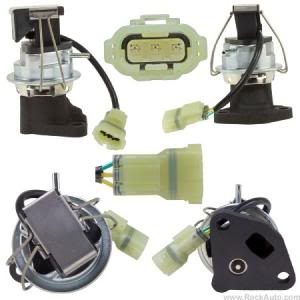

EGR system is controlled by the ECU, which gets some of it's info from the O2 sensor and crank angle sensor. I think what is happening is the crank angle sensor has gone bad or is unplugged or has a bad wire/connector, throwing off the O2, which in turn throws the EGR off. Although, it could be the O2 sensor came unplugged or has a bad wire/connector. Start by checking connections at the O2 sensor and if you have an EGR then remove and inspect/clean the solenoid, the EGR vacuum solenoid and the EGR ports.
EGR solenoid looks like this:
