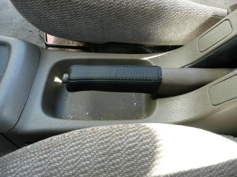

1st photo: before - ugly old worn plastic handbrake grip. On my car, the pushbutton for the handbrake doesn’t stick out very far. I don’t know why, it just doesn’t.
1. Start by removing the e-brake boot from the handle. Just pull it gently off of the ridge on the handle (2nd photo).

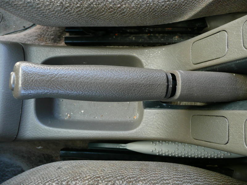

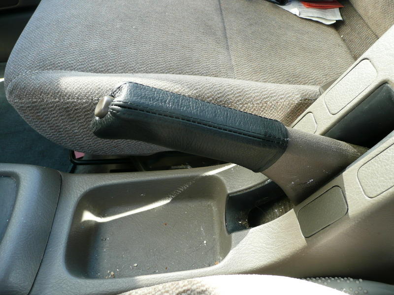

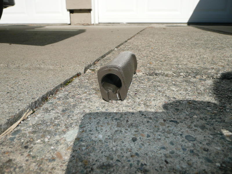

2. Remove the e-brake handgrip. You simply pull it off the e-brake lever. Twisting might help break it loose, but do not twist it much because there is a ridge and groove that keep it straight (3rd and 4th photos). You may find it easier if you remove the button at the end of the handle first. To remove the button, simply unscrew it. In my install, I did not need to remove the button.

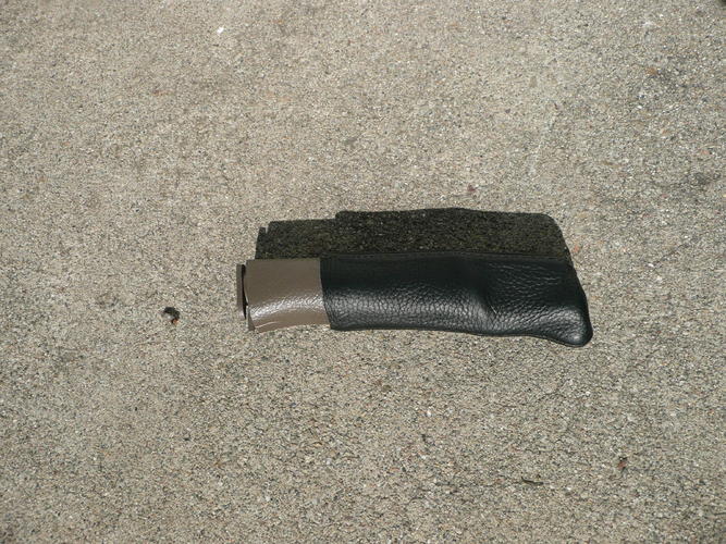

3. Stretch the leather cover over the handbrake grip. This can be difficult, as the fit will be tight over the contours of the grip. Be patient and persistent - the leather will stretch. Putting some lubricant on the grip will help the cover slide on more easily. I like to use 303 Aerospace Protectant, which will help protect the leather. Dish soap will also work. See 5th photo.

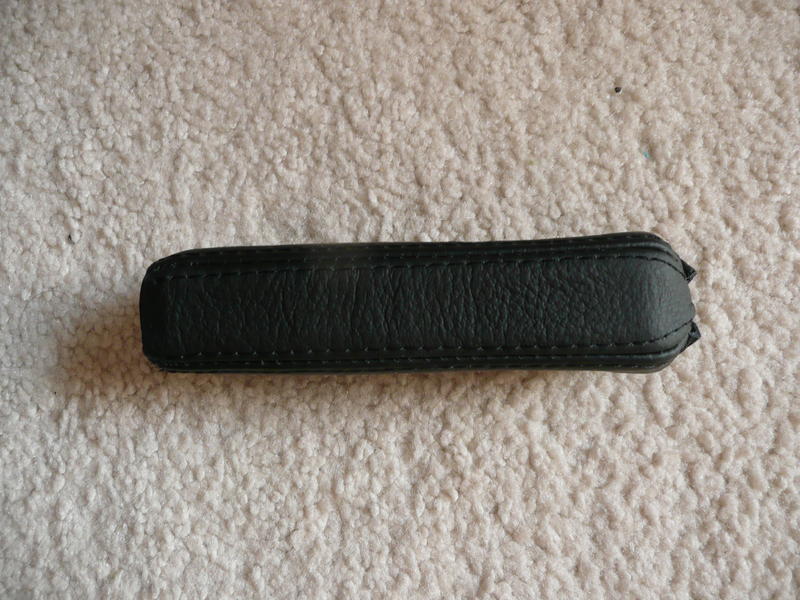

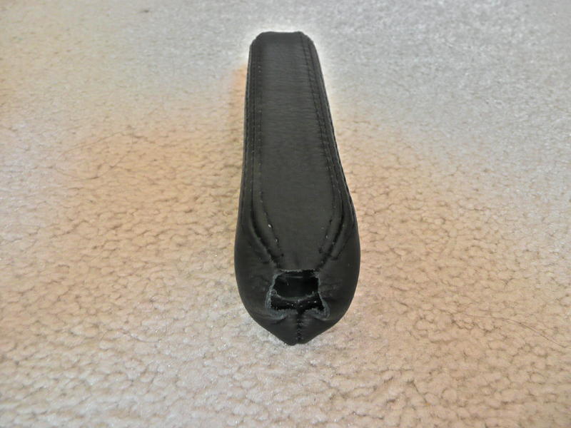

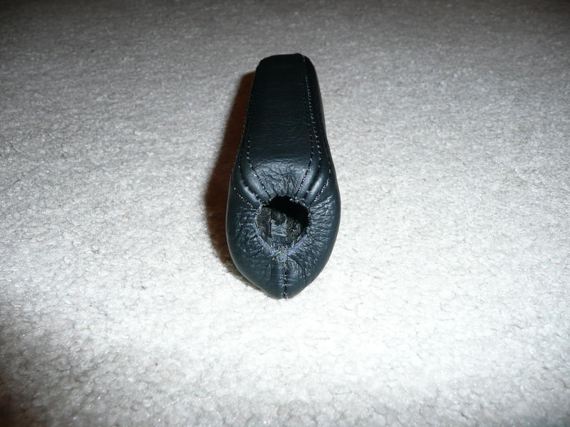

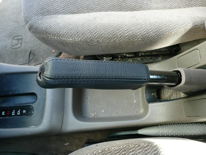

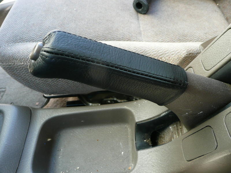

Continuing the install: we now have the leather cover on the handle. See 1st and 2nd photos.

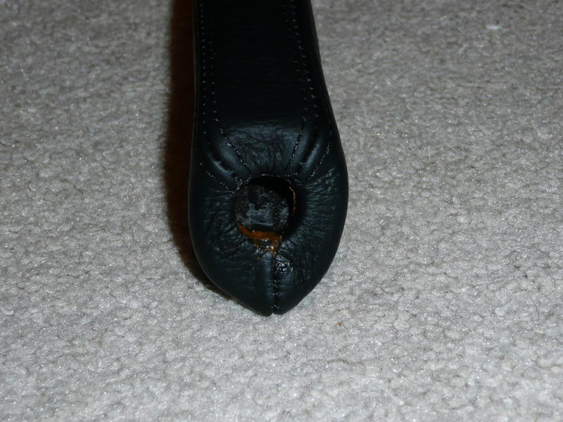

Step 4. Glue down the loose areas at the ends of the handle. Pliobond works well, and is easily removed if you get some on the leather (use a mild solvent like Goo Gone). Epoxy works well for edges and tricky areas. A hot glue gun and upholstery glue are some other options. 3rd photo shows the loose ends. 4th photo shows the ends glued down.
5. Trim around the hole for the button at the end of the grip using a very sharp knife or razor blade. Make sure there is enough clearance for the button to go through the hole. 4th photo shows after trimming around hole for button.

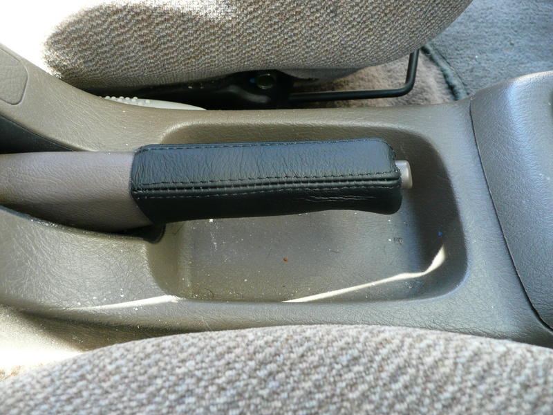

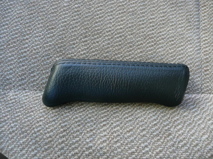

6. Reinstall the handgrip onto the e-brake handle. This is the reverse of the removal – simply work the handgrip onto the handle, making sure to align the tongue on the handle with the groove on the grip. 1st photo shows starting the process.
7. If you removed the button on the end of the handbrake lever, reinstall it by screwing it back on.
8. Admire your handsome new leather e-brake handgrip cover!

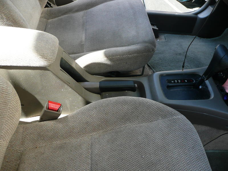

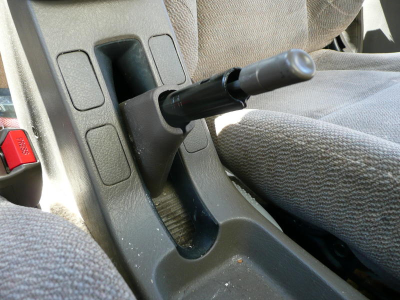

A couple more pix to finish up the thread.
The e-brake grip cover is a new product, and I don't think Redline Goods has them listed on their site yet. But you can contact them and get one ordered.
