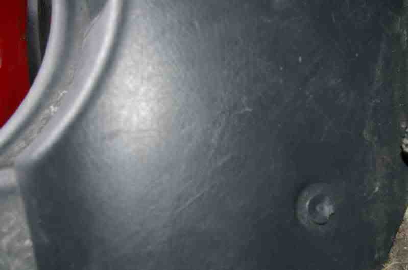

Remove plastic tab from driver side kick panel.

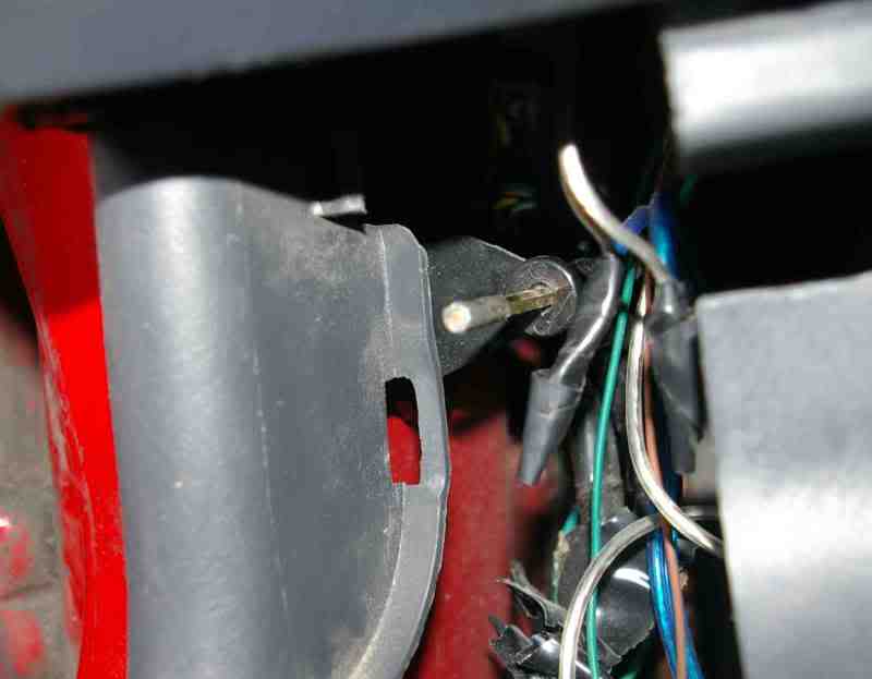

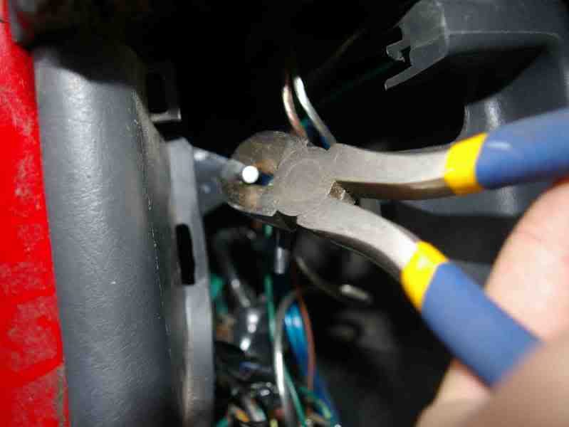

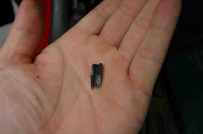

Unhook the kick and swing it out of the way. Using a pair of wire cutters cut the remaining plastic off.
It should come of in large chunks since it's very brittle. This is why it broke in the first place.
