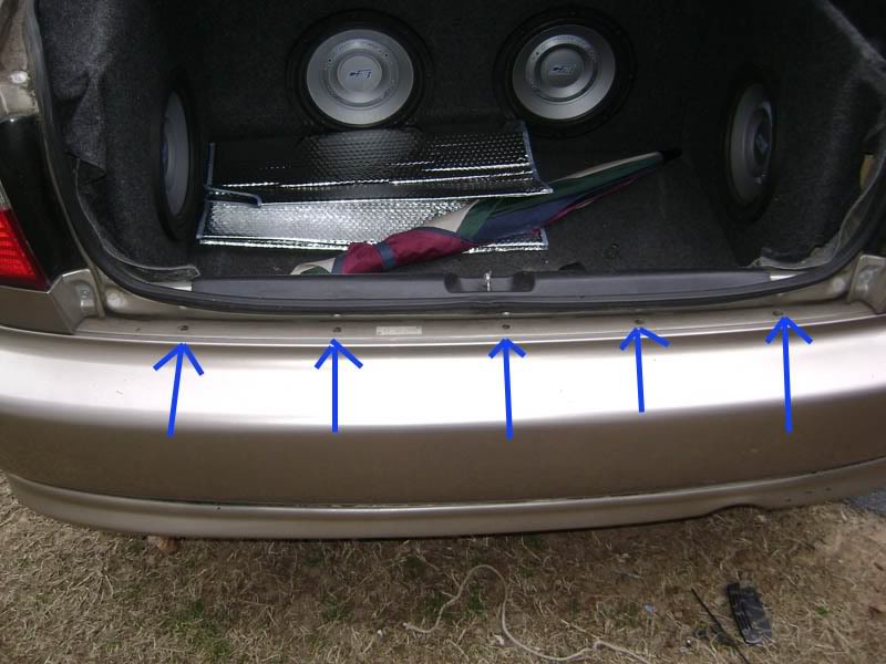

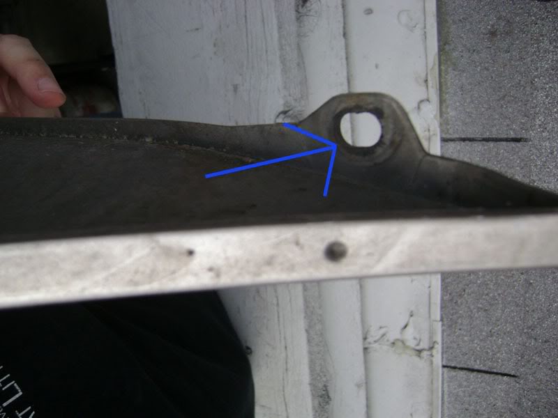

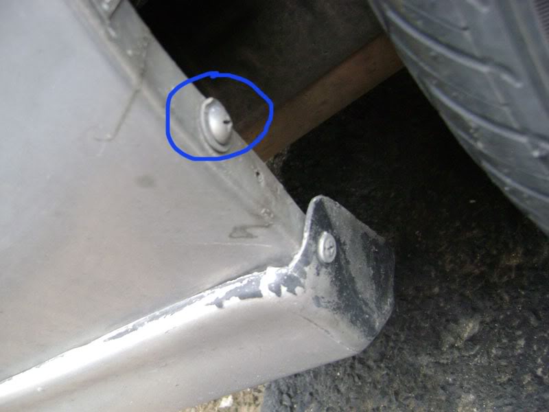

1. Remove the two screws on each side. The first one is right at the top of the side of each bumper. I didn't get a picture of it on the car but the location is pictured. The second one is pictured circled below.
2. Remove the two clips on the underside of the bumper. They'll either be the type you pry off with a flathead or the type that unscrews with a phillips.
3. Remove the 5 clips from the middle of the bumper.

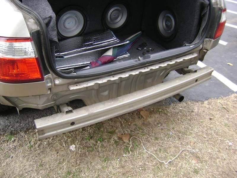

4. Pull.
...Really, that's it. Boom. It's off. Go do what you were going to do with the bumper.
