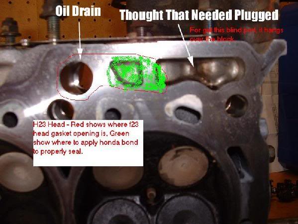

WHEN USING THE F23 HEAD GASKET, YOU MUST REMOVE ONE SMALLER COPPER FASTENER THAT HOLDS THE 3 LAYERS TOGETHER. ONE WILL STILL REMAIN AND HOLD THE LAYERS TOGETHER. IF YOU DO NOT THE HEAD WILL NOT SEAL PROPERLY.
15.Flip h23a head on a table or some work-able area place the f23a Head gasket on it and fill in the blind hole with hondabond and with your finger rub some of the hondabond in that part of the gasket.
