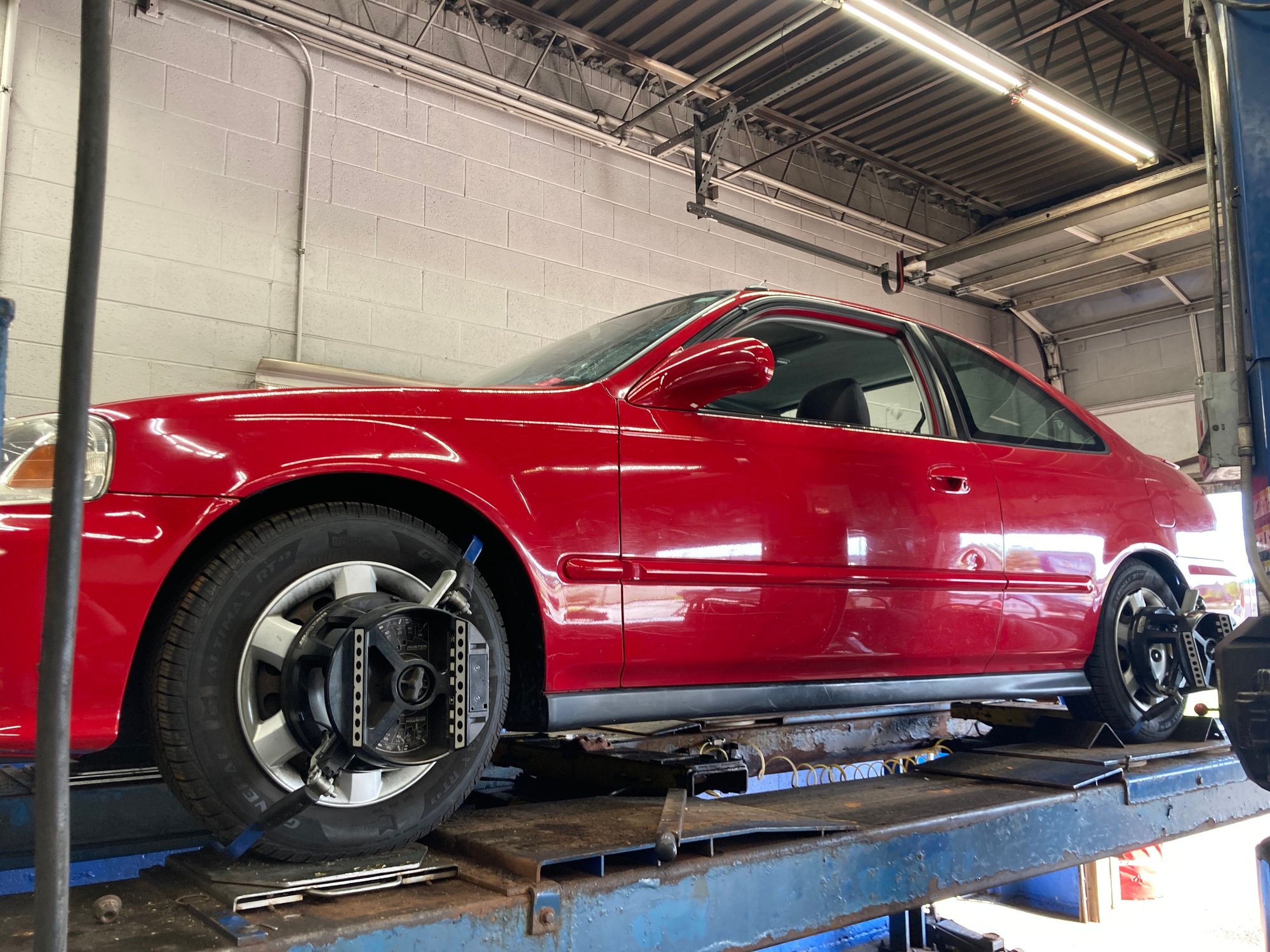

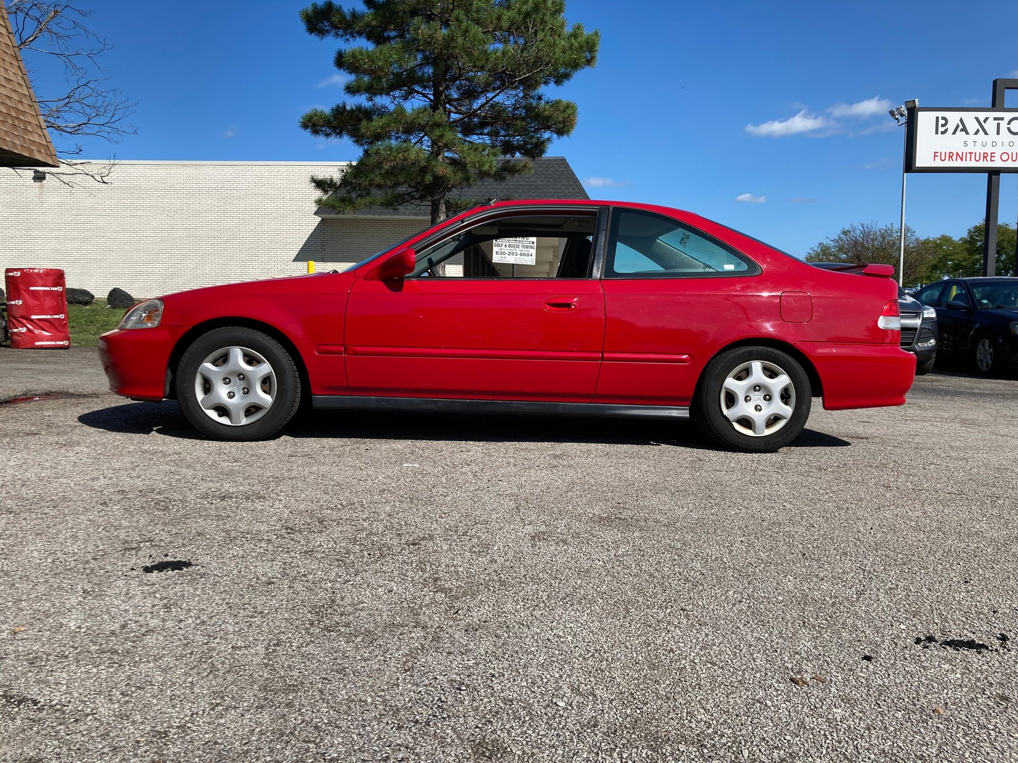

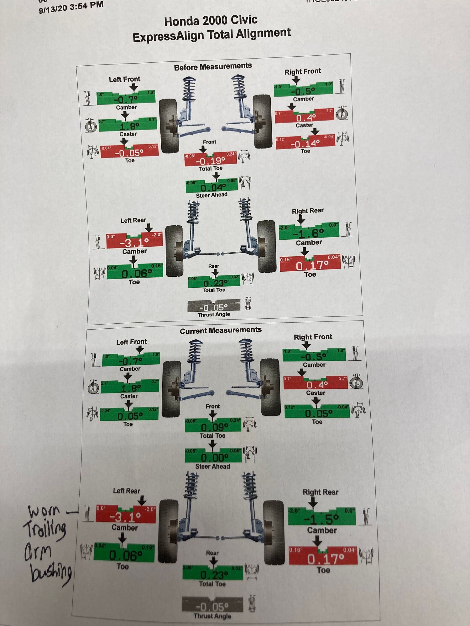

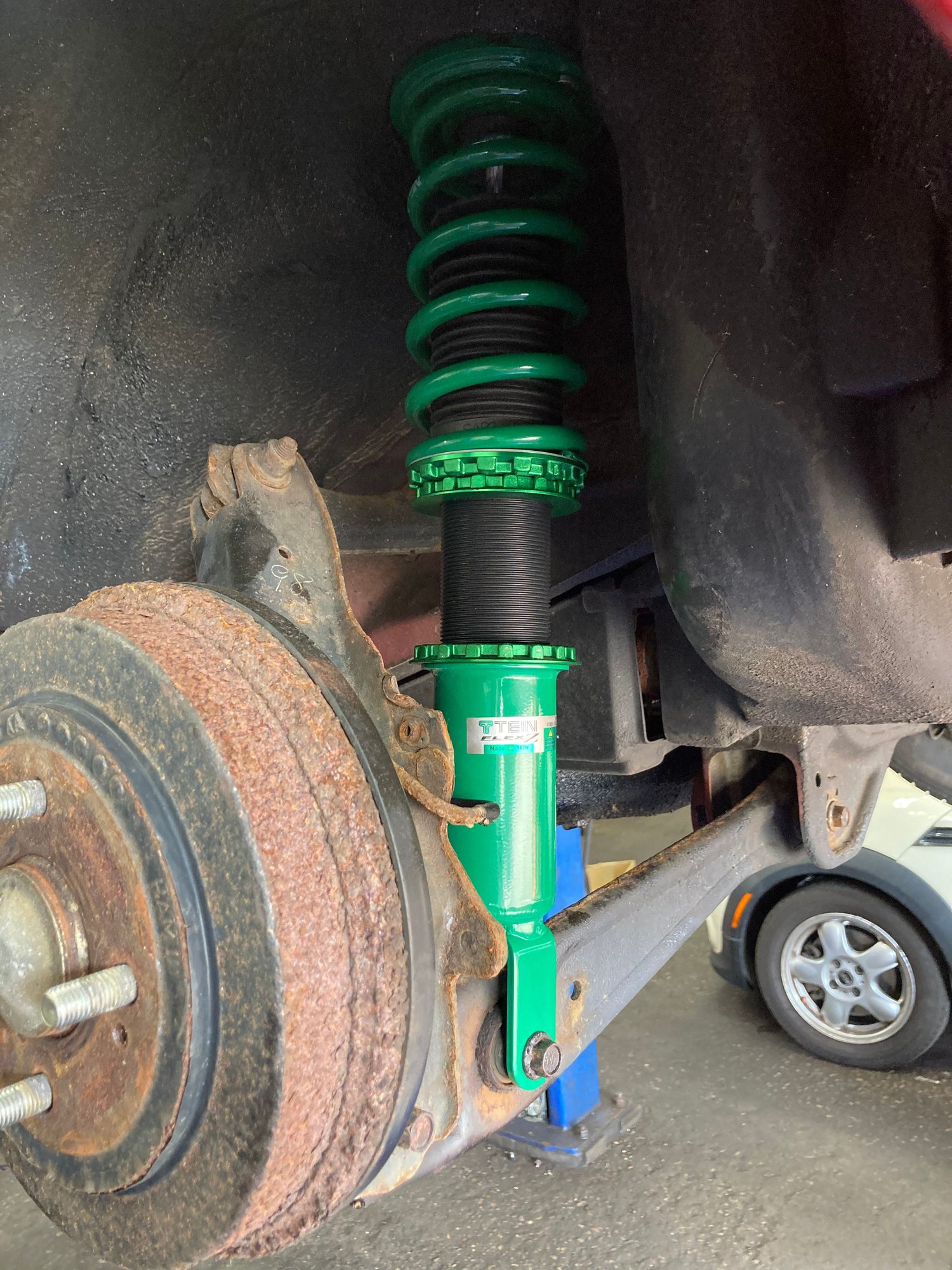

Just installed TEIN Flex-Z coilovers onto my EJ8, and my rear camber is sitting at -1.5 degrees on the right side (how it should be) and due to a worn LR trailing arm bushing, the LR sits at -3 degrees of camber. Once I replace the trailing arm bushing, what other aftermarket parts can I add that will allow me to further adjust the rear camber?
ideally I would like to have around -1 degree in the back. Check out my photo gallery for pictures
Alignment after coilover install
Ride height with coilovers installed
Rear coilover length adjusted to 18” from top of spring to absolute bottom of assembly
