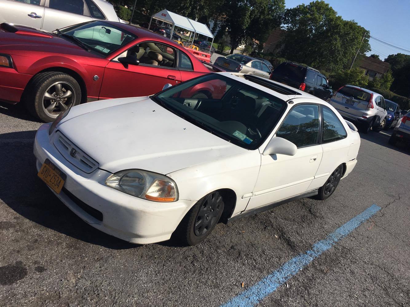

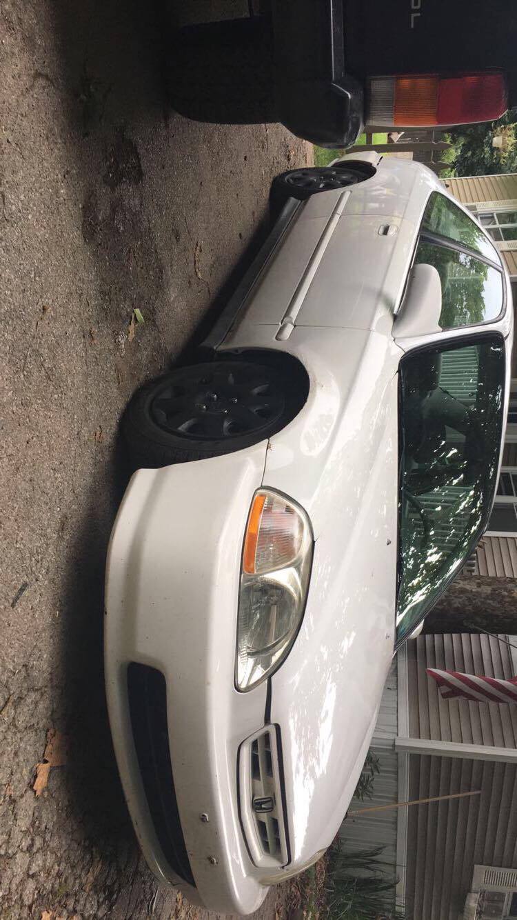

Just bought a EJ8 and it came with Ground Control Coils and Eibach Springs and this thing is way too low.
I tried to adjust them up, but the car still sits way too low.
Before:
After:
I got the lock spinner thing almost all the way up and its still way too low.

So are you asking how do I raise it more?
Either buy stock springs and put them in or get GC to make you taller springs.

Yeah I need it raised more. How do I find what size sprint I should use?

If you get OEM ones just get the ones for the 6th gen civic.
If you go with Ground Comtrol they know what size you need. Just tell them what you want to do and they will make the spring size and rate that works the best.
You could even buy aftermarket just make sure they are OEM equivalent and not lowering springs.
