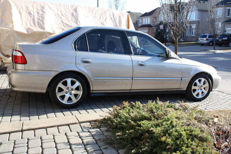

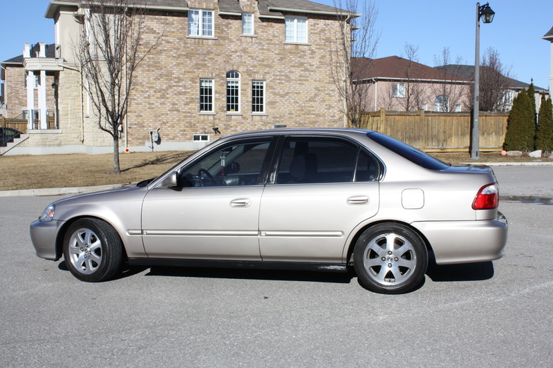

Hi, I have the prokit installed with Koni Orange, the drop is about one inch all around. Just an alignment after the installation (no camber kit). The ride quality is great. I suggest you upgrade the shocks and the spring at the same time.
See the pic below:

[QUOTE=bluejays26;4681613]Hi, I have the prokit installed with Koni Orange, the drop is about one inch all around. Just an alignment after the installation (no camber kit). The ride quality is great. I suggest you upgrade the shocks and the spring at the same time.
that sedan is clean! nice ride with the si wheels!
ditto...that is a nice looking Civic. I looked for those rims for a month without any lucky before I bought my alloys.
Thank you for the comment
