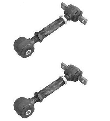

I know for a 1.5 inch drop I don't really need a camber kit but I was also reading that you can buy an Ingalls rear camber kit and have the ability to adjust both the camber and the toe? Is that what I need to fix the toe?
Am I looking at the right Ingalls rear kit that can adjust both the toe and the camber?

Or is it this?

the first one is for the 7th gen (different animal)
not sure of the second one - did you select them by your car year?
