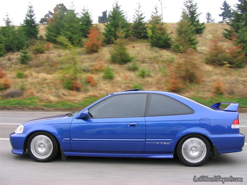

Heres a pic of an EM1 with the same size rims and tires:

Progressive springs get progressively (hence the name) stiffer as they compress, so that's probably why your subs are making your rear end sink a bit. At rest they're a bit softer than the 275 they're rated at. Either that or the 275 is the average. Not 100% sure on that.
The roads where I live are pretty bad. Busting an oil pan is probably more of a volkswagen fetish, and probably an overstatement, but 3'' is still a big drop. It's not quite slammed, but with that tire size on Si rims I can see it looking pretty good. Snap oversteer is rare, but if you do something like let off the gas mid-corner it's possible.
But anyway, back to your original question, neuspeed's are great, but I would look into getting a linear spring instead of a progressive spring. That might fix your "lower in the back" problem. I think neuspeeds make linear springs, I am not sure. Linear's have kinda gone out of style since progressives are much better for daily driving.
Having height adjustment isn't really necessary if you're just after looks. I'd save the money on the GC sleeves. If you want to drop it 3" like you mentioned before, you're definitely gonna need camber kits to tuck the wheels.
