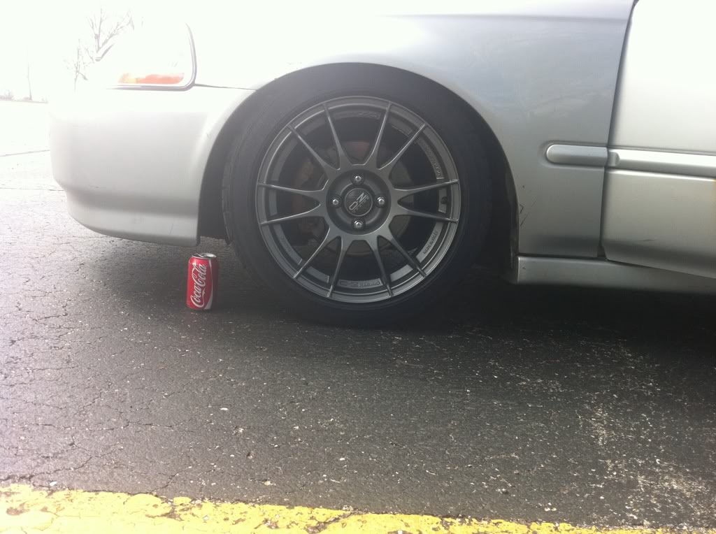

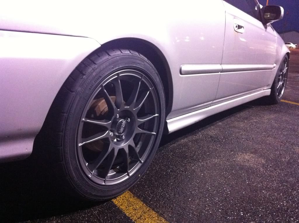

Let's see if this works
Old Apr 17, 2011
BlueEM2's Avatar
Whachya lookin at?
Joined: May 2009
Posts: 6,388
Likes: 13
Rep Power: 314
Re: 98 honda civic ex coupe lowered
Seems your rear end is higher than your front. What kind of lowering system are you running?
I put Koni sports struts and H&R springs on. They are at the highest adjustments. Then I went from 14" to 16" wheels which are a little wider. I softened the dampers about a half turn to make the ride softer so I didn't feel every bump. I just want to be able to raise the front end about an inch. But my main concern is the steering. I've got the camber set -1.5 and the toe -0.1. The caster is completely off. I have one wheel back farther than the other.
Old Apr 17, 2011
BlueEM2's Avatar
Whachya lookin at?
Joined: May 2009
Posts: 6,388
Likes: 13
Rep Power: 314
Hmm... your absolutely sure its at the maximum height? That front end looks like its been dropped 3-4" as you said. I wonder if your struts are having issues already
Oh the rears have 3 pre settings. Fronts have two.
Old Apr 17, 2011
BlueEM2's Avatar
Whachya lookin at?
Joined: May 2009
Posts: 6,388
Likes: 13
Rep Power: 314
Well.. I don't think your going to get fender rub because being that low the suspension must be really stiff... so maybe lower the rears to match the fronts for now.. Get your struts checked out to make sure they are still okay because the drop is a lot lower than you expected. How much of a drop are the struts rated for? If they are too low they can blow quickly.
Old Apr 17, 2011
Posts: 15,180
Likes: 1,606
Rep Power: 367
RU sure you did not put the front/rear springs inversed?

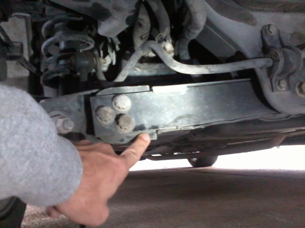

Ok. Put my car in the air. Before im able to make adjustments I noticed my tires inner tread is gone. I'm told I have too much positive toe...basically Im dragging my rear tires. I've only had these on 4 weeks. I'm told I need to replace the upper control arms in the back with adjustable ones for the toe. But I also need the part for adjustable camber. Anyone have suggestions for parts/websites? Be much appreciated. Thanks!
