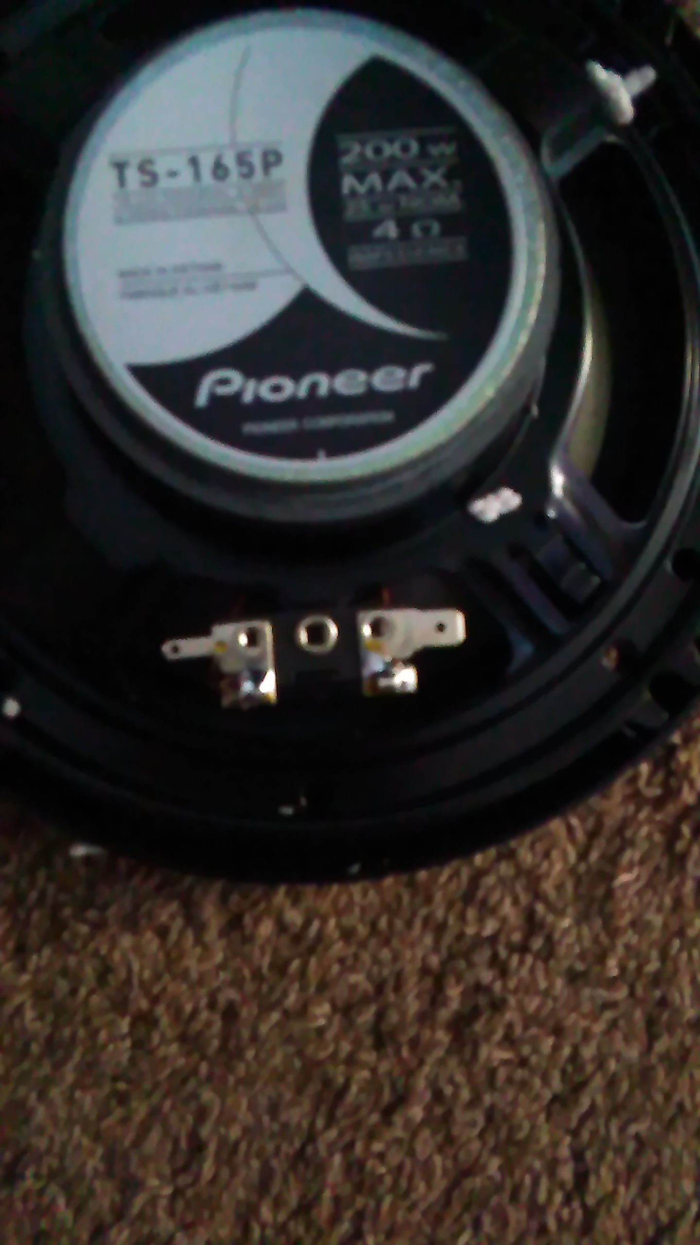

Here's my first issue. Which one is positive and negative?

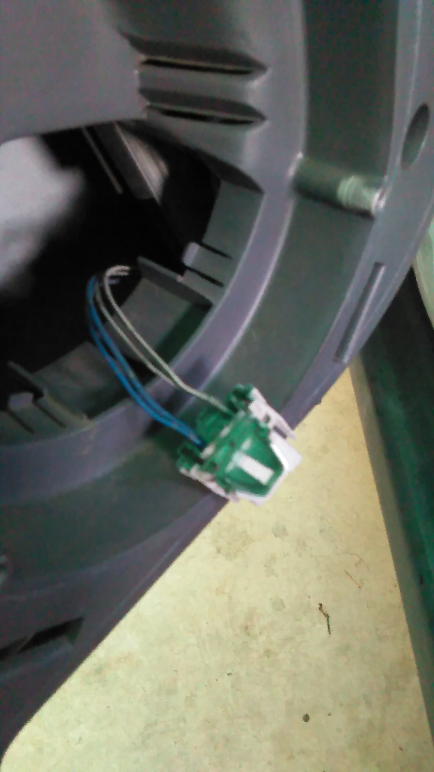

What are all these wires. My speakers came with a white wire and a white/grey wire but what are the blue set of wires and what do they connect to on my aftermarket spearkers?
Do I chop off this stock harness or is there an aftermarket harness I can clip to my side speakers?

Fat terminal on speaker is + (Crutchfield forums answer)
Second set of wires goes to tweeters when equipped. If not equipped the wires may still be present anyway.

front left
Blue +
Gray -
front right
red/grn +
brn/blk -
I might crimp some male spade terminals onto the new wiring and just make little short jumpers to connect with the original plug

What do I do about the leftover wires. I think I have tweeters next to my side view mirrors, they look like mini, round speakers.

On my second picture
There are 2 sets of wires, 4 total.

I only have 2 terminals.
I have 2 wires leftover

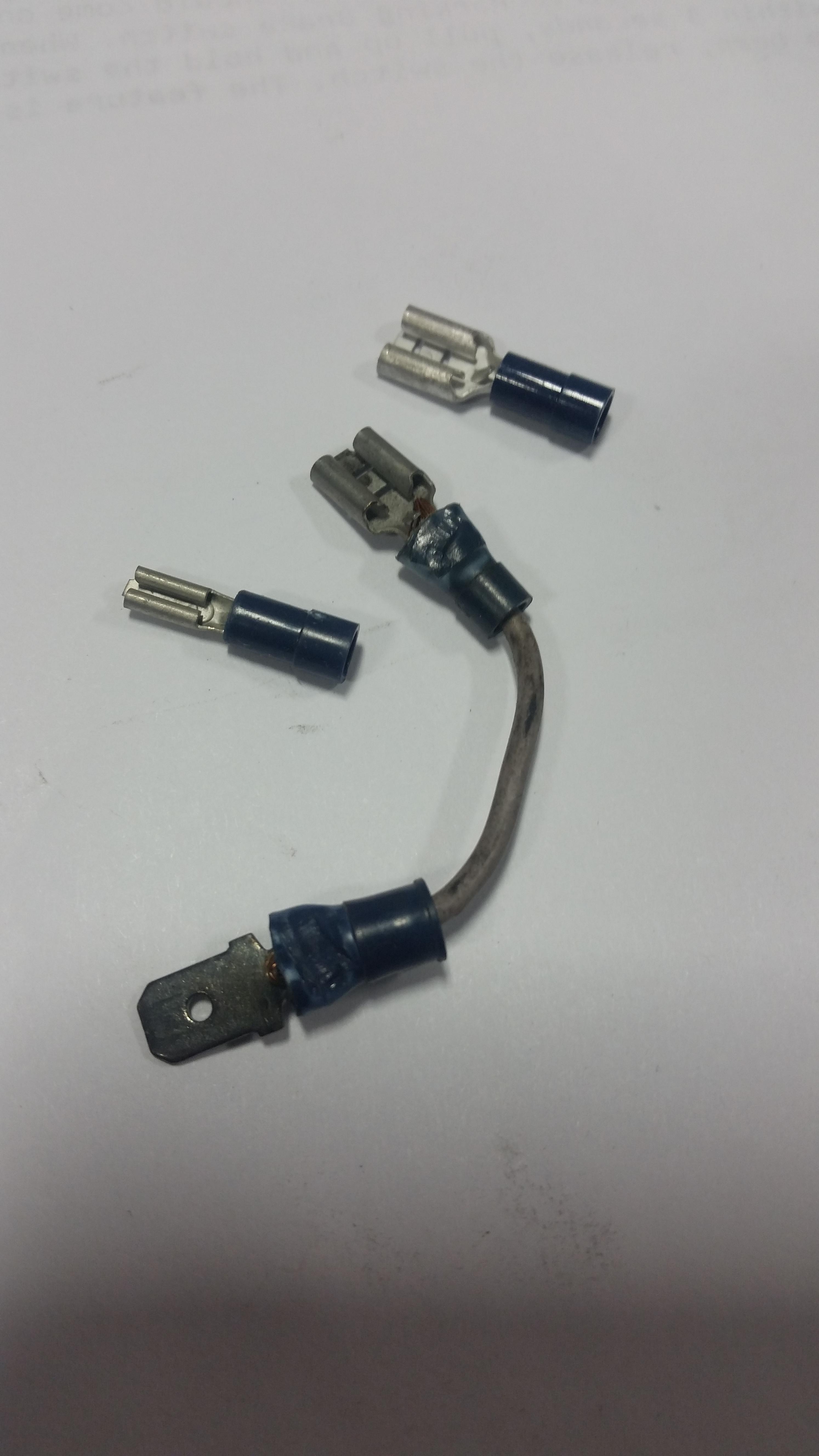

Extra wires? I'd leave them all alone. I'd grab a few crimp-on spade connectors and use the new wiring, whip up a few jumpers similar to this:

plug into the new speaker and the original connector, tape in place so they can't fall out

Yo, these guys are saying the front left (-) is gray/black
WHAt car are you working with? I used a 99 diagram since that's the car in your info. Did I miss something? If not a 99, I'll have to regroup.
From your link, for a 99 Civic:
Front Speaker Size and Location: 6 1/2″ Doors
Left Front Speaker Wire (+): Blue
Left Front Speaker Wire (-): Gray/Black
Right Front Speaker Wire (+): Red/Green
Right Front Speaker Wire (-): Brown/Black
What I posted above
front left
Blue +
Gray - (should be gray/black, sorry)
front right
red/grn +
brn/blk -
Looks almost exactly the same to me. How about you?
More edits: There are actually more colors listed in my diagrams, colors may change among different harnesses between the radio and the speaker
left+ = blu, blu, red/grn or blu, 96-97 model blu, and red on the tweeter
left-= gry/blk, gry/blk, brn/blk or gry/blk, brn/blk 96-97, and blu on the tweeter

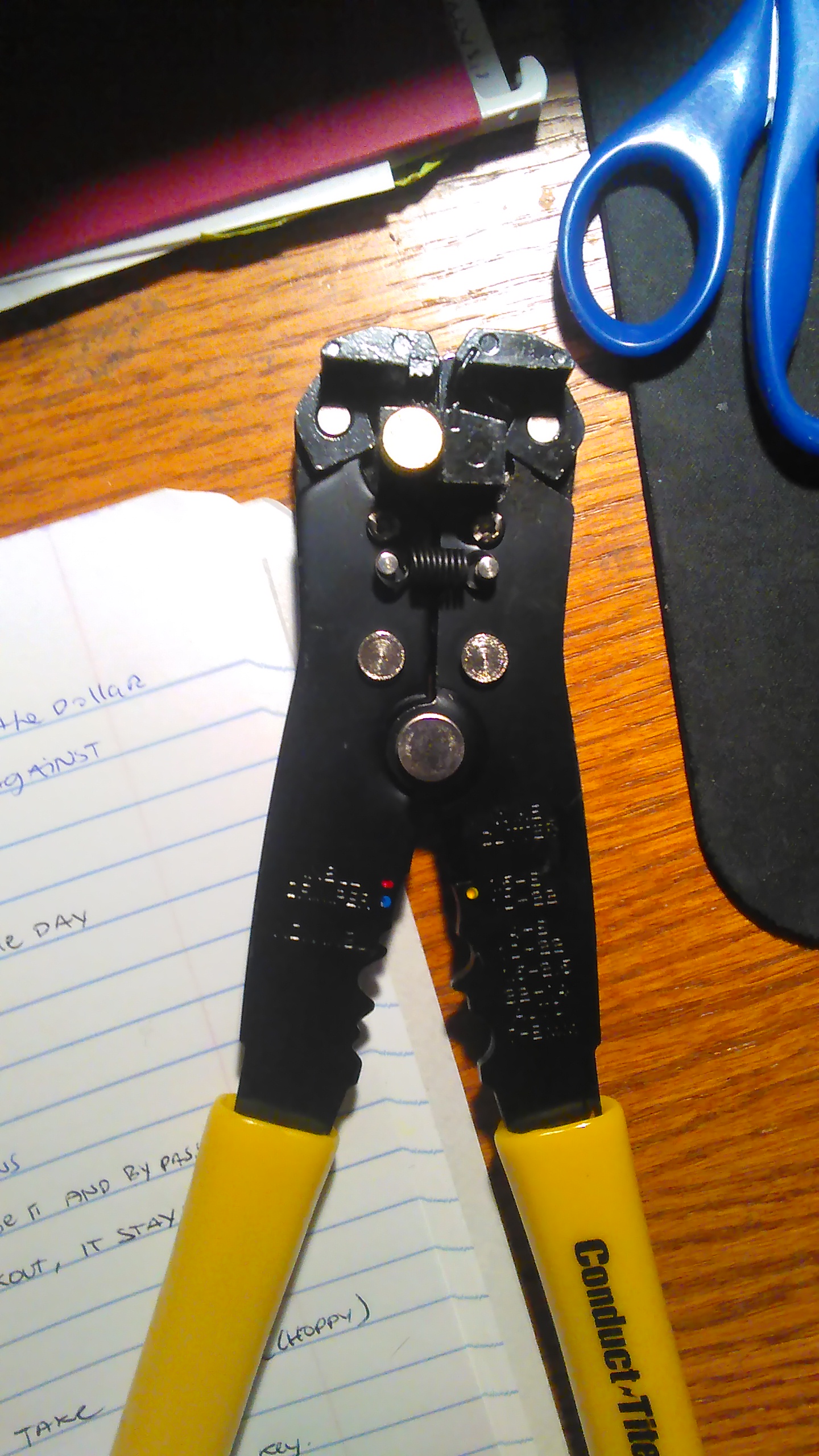

I also bought one of these bad boys. Life is heck of a lot easier with the correct tools for the job
I felt like a monkey figuring out how to use it, though.
