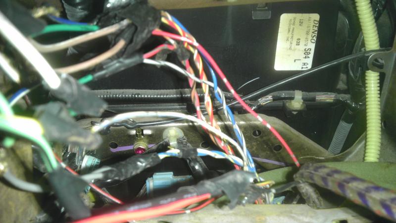

So a co worker of mine recently acquired a 2000 LX sedan from an auction. Someone had installed an after market sound system and tore it all out before auction simply leaving an unconnected stock radio just sitting in the dash.
The problem is, whoever installed the previous system and what also looks like one before that, did a hack job. As you can see in the picture it appears someone cut out the OE radio connecter at some point, then someone cut out that leaving two different spliced connections simply twisted together and covered with electrical tape...sigh.
The connector this ugly mess of wires is currently connected to is clearly for an after market receiver with numerous wires not connected to anything. One of them was wrapped around the metal prong of a 15A fuse then stuck into one of the un used fuse ports under the dash....???
I have installed a sound system before in a ford ZX2 but all the connections were not butchered, so it was pretty straight forward.
My thinking is that I should remove the wires at the first spliced connection, and then splice them all back (properly) into an OE radio harness. Would this one work?

Got to love hack jobs!! That looks like a complete mess. All the adapters you found on Amazon looked like the correct ones according to the description. I agree, cutting everything out and splicing in a new factory harness would be the best route. I would try to convince the car owner to get a little better head unit also. Here is a pic with the bolts that I think you are talking about:

What do you think about figuring out which wires would splice into the replacement OE harness. The color of the wires listed here (http://www.modifiedlife.com/2000-hon...iring-diagram/) don't match up to the ones currently in vehicle as far as I can tell. And the wires from the OE replacement harness are way different than what is currently in vehicle as well.
I dunno how accurate that diagram from modified life is. But from what I can tell, the twisted pairs of wires in the pictures seem to be for the speakers, then the loose hanging ones are the power, illumination?, I think that yellow wire that was clipped into an empty fuse was acting as ground...

I agree that splicing in another OEM wiring harness is the best coarse of action. A guy could do a proper job connecting an aftermarket HU to the mess that was left for you, but splicing in an OEM harness gives you more wire length and makes swapping HU's easier later down the road.
