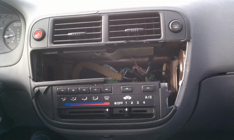

Some Grinch decided to break into my car and viciously rip out my aftermarket head unit. Broke tons of pieces on the plastic bezel around it and the whole thing needs to be replaced. Anyone have a good DIY?

I have already ordered one from ebay, I just need instructions on removal and replacement.

to remove it you will need to drop the plastic panel below the deck there are philips head screws that need to be removed and then unclip the connector for the climate controls.

You also need to remove your hazard button and rear defrost there is a screw behind each. In the pass. Side there is a cable coming from temp control that needs to be removed any questions feel free to message me.
