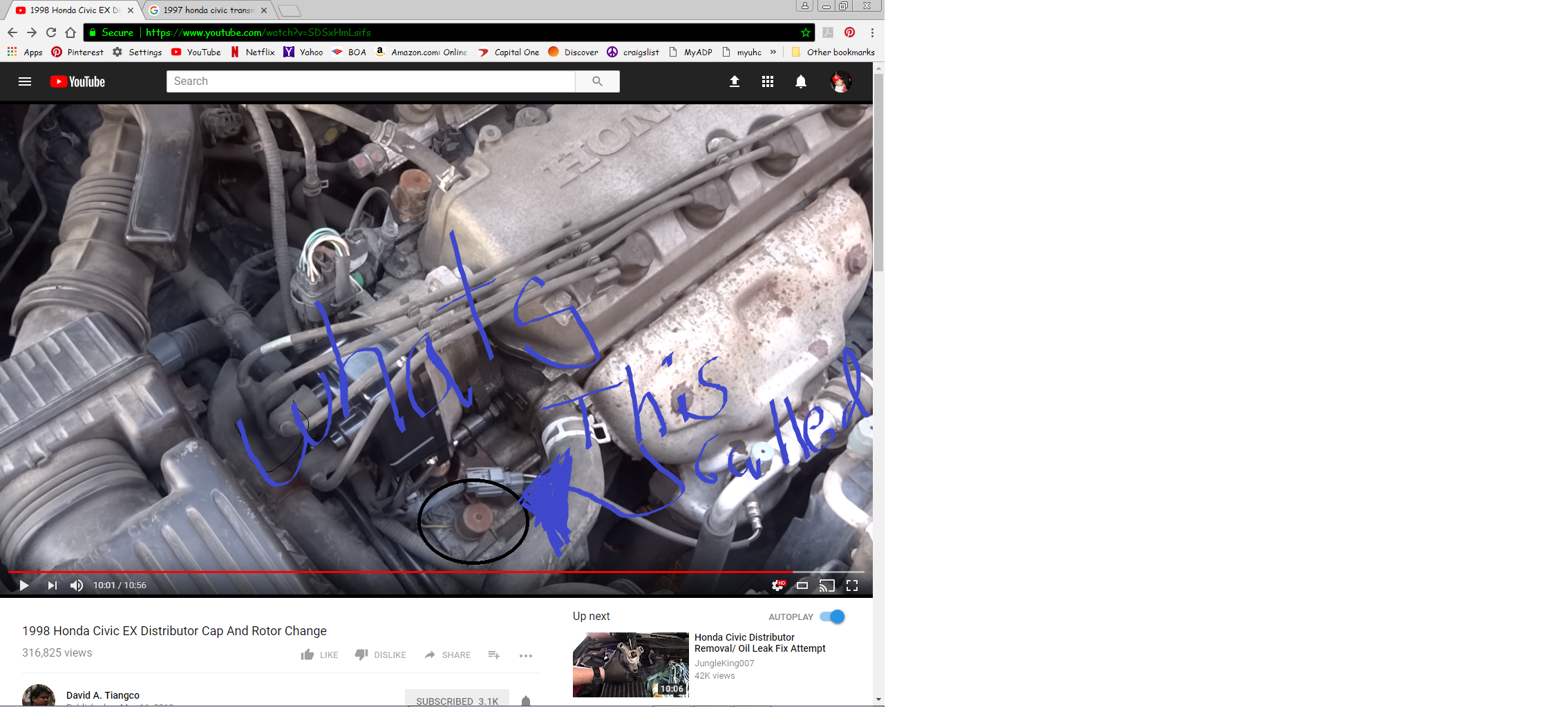

Just like the tittle says... I recently bought a 97 civic vtec but noticed there's a missing part and a wire exposed guessing it connects to something that connects to a metal tube like a dipstick but not... The picturew i uploaded is not from my vehicle but off a youtube video I came across but couldnt find another explaining what the parts name. Thanks in advance!

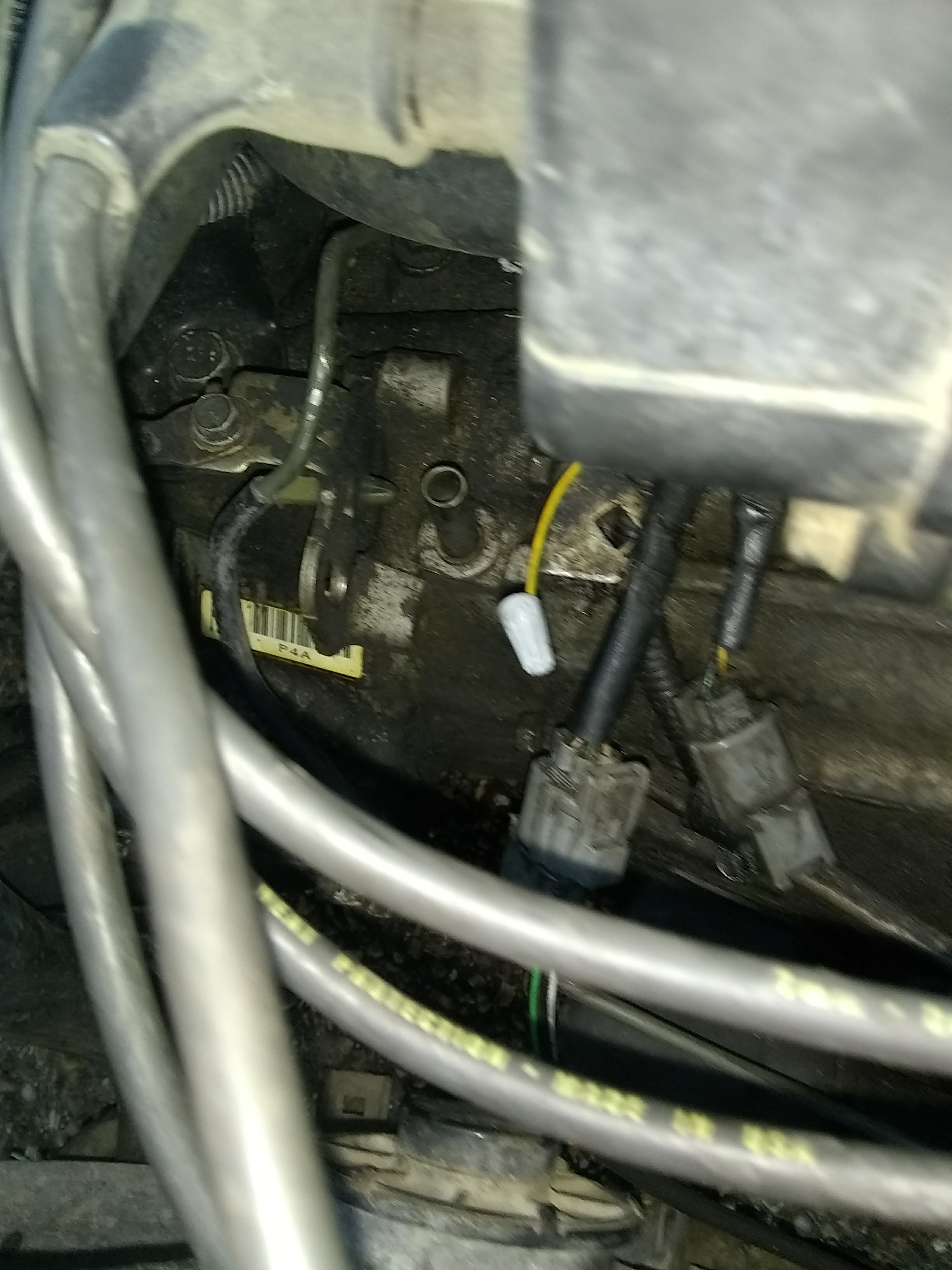

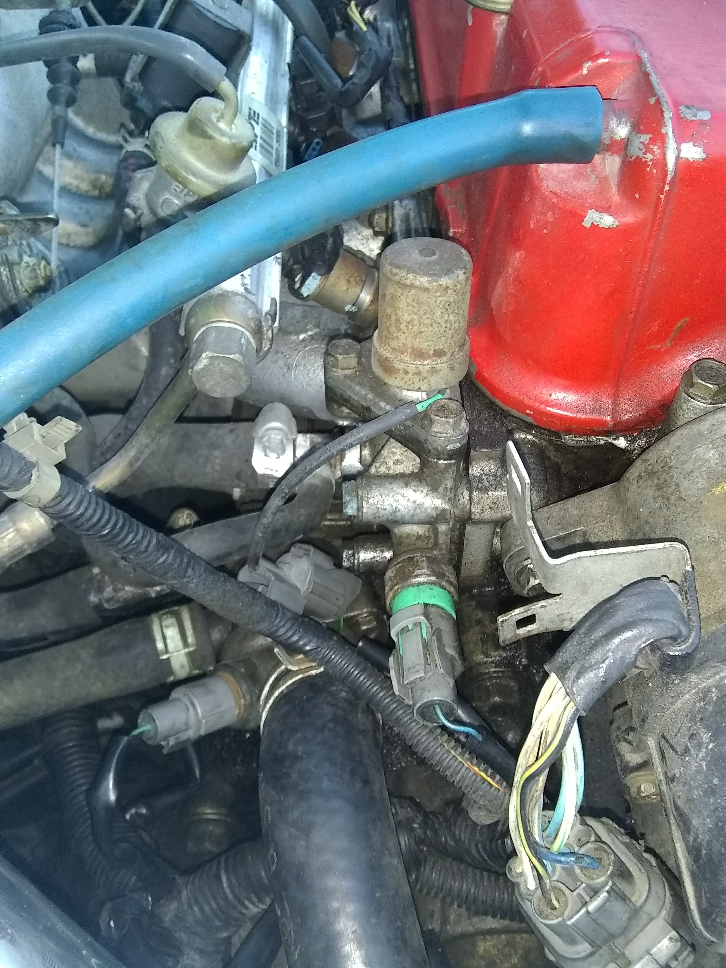

Here is the pics...The second pic is the rear solenoid for VTEC I think

First pic, open tube sticking up is just that, a tube sticking up. It's the trans vent and is supposed to have a special rubber cap to keep dirt out (yet still allow air movement)
Yellow wire, can you follow it to see where it goes?
Second pic, what is it showing? The single wire for the VTEC solenoid is not connectd to anything? If so, its mate should be green with a yellow stripe...might come out of the harness below the distributor

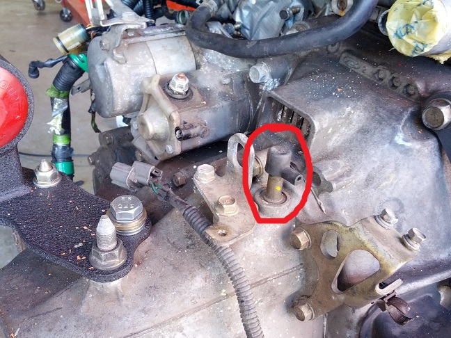

If you see the pic I first posted regarding the video I saw with the circle i outlined, theres a yellow wire that connects to that cap thing that goes placed on that tube cap... but...Sweet Thanks Bro's ... Appreciate it... problem solved lol
That's a solenoid on an automatic trans.
Your own cars pic looks like it has a manual trans?
