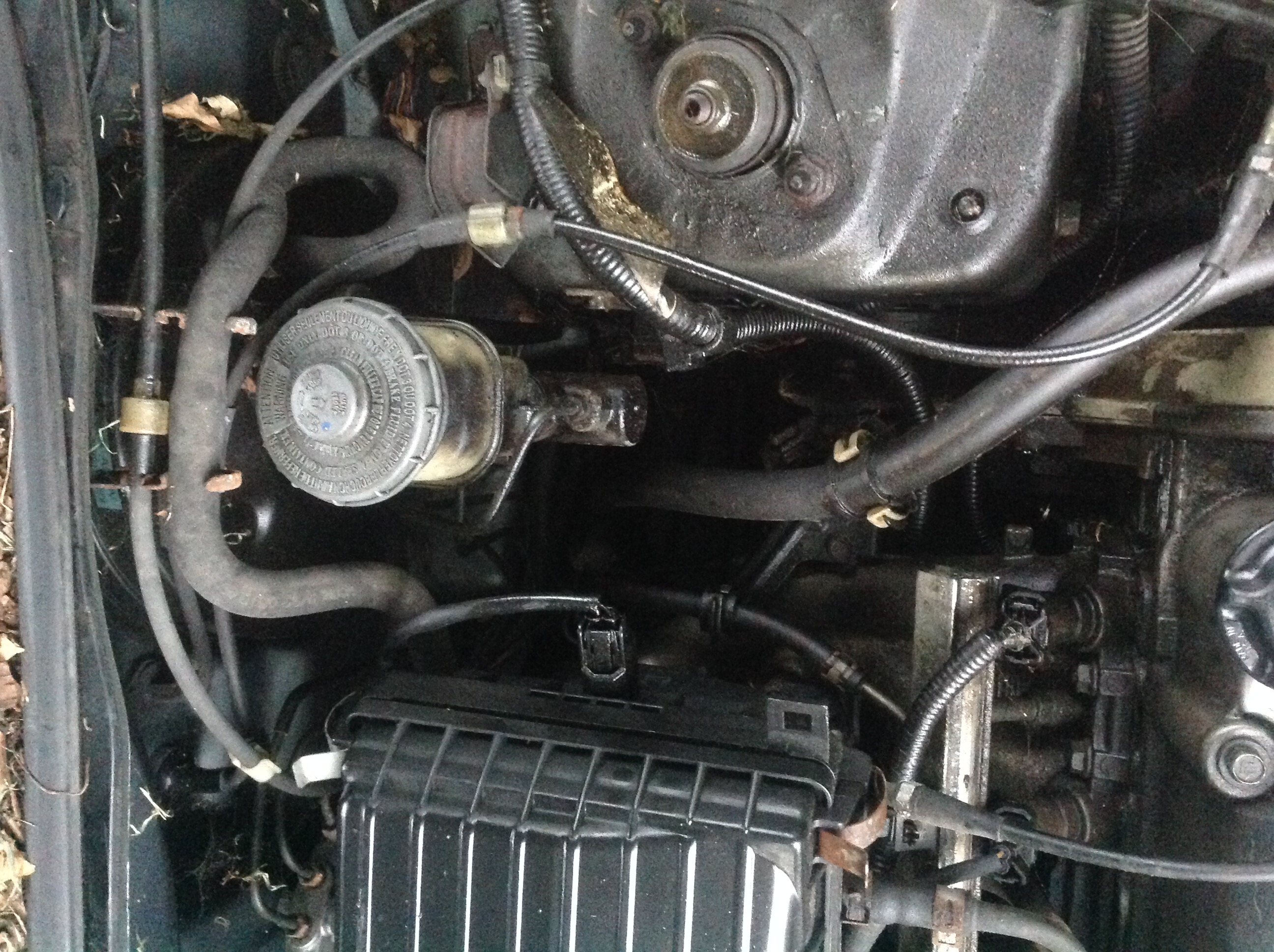

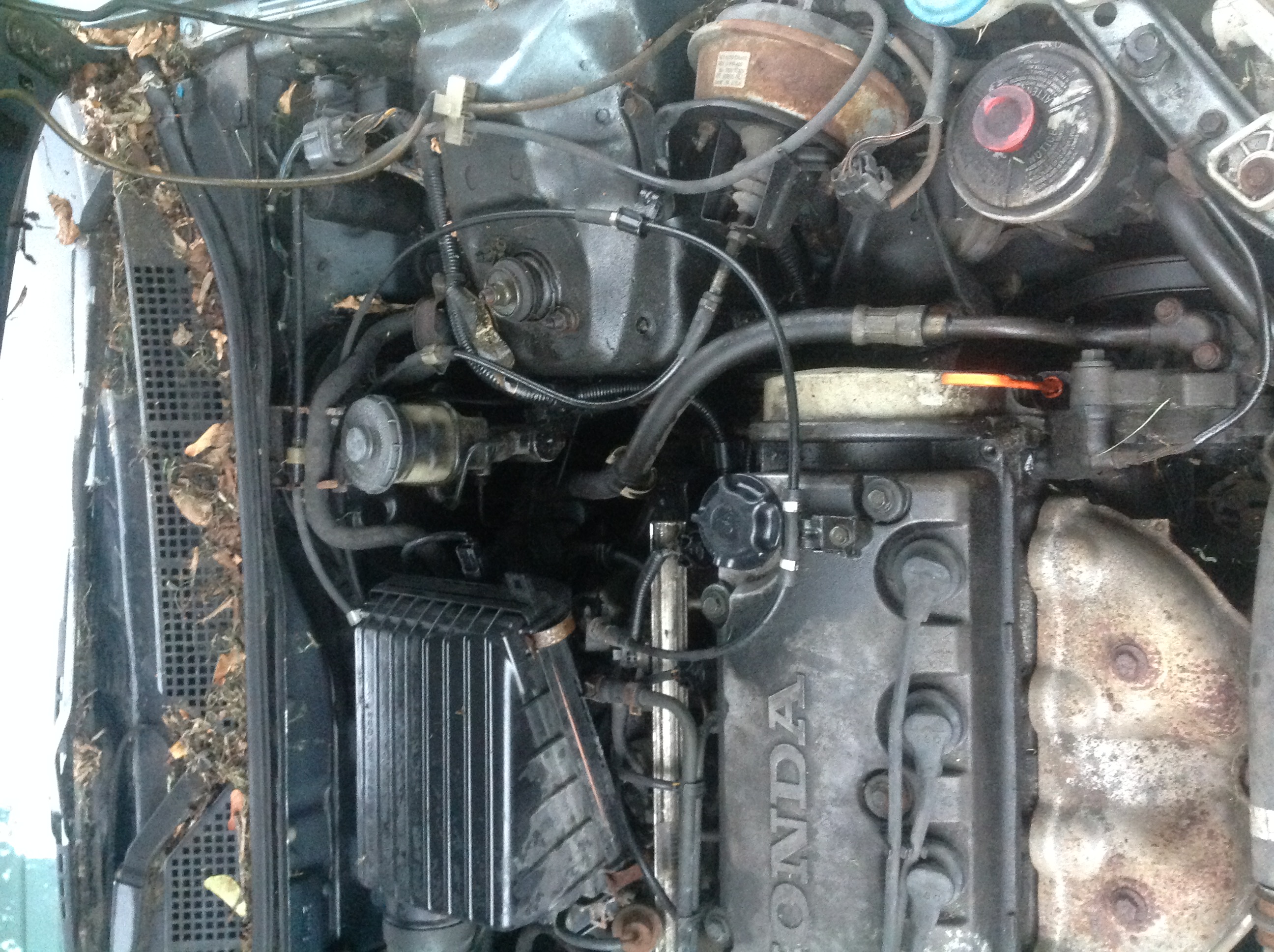

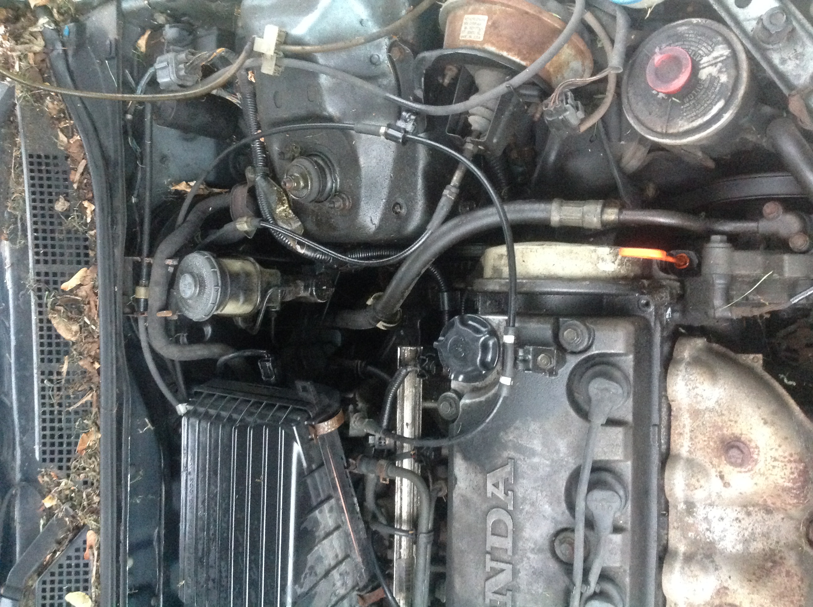

There should be three pictures attached to this post for you to see...If someone needs to see a certain something let me know, I shot the video the best I could, along with the pictures.
ID:	111578   Click image for larger version

If it's throwing oil out behind the engine, I might look at the oil filter to see if it's damaged and check the oil pressure switch that controls the warning light.
Just slide under it with a good flashlight and look around for fresh drips, look up the back of the engine for the fresh drips
High idle...same suggestion post #6

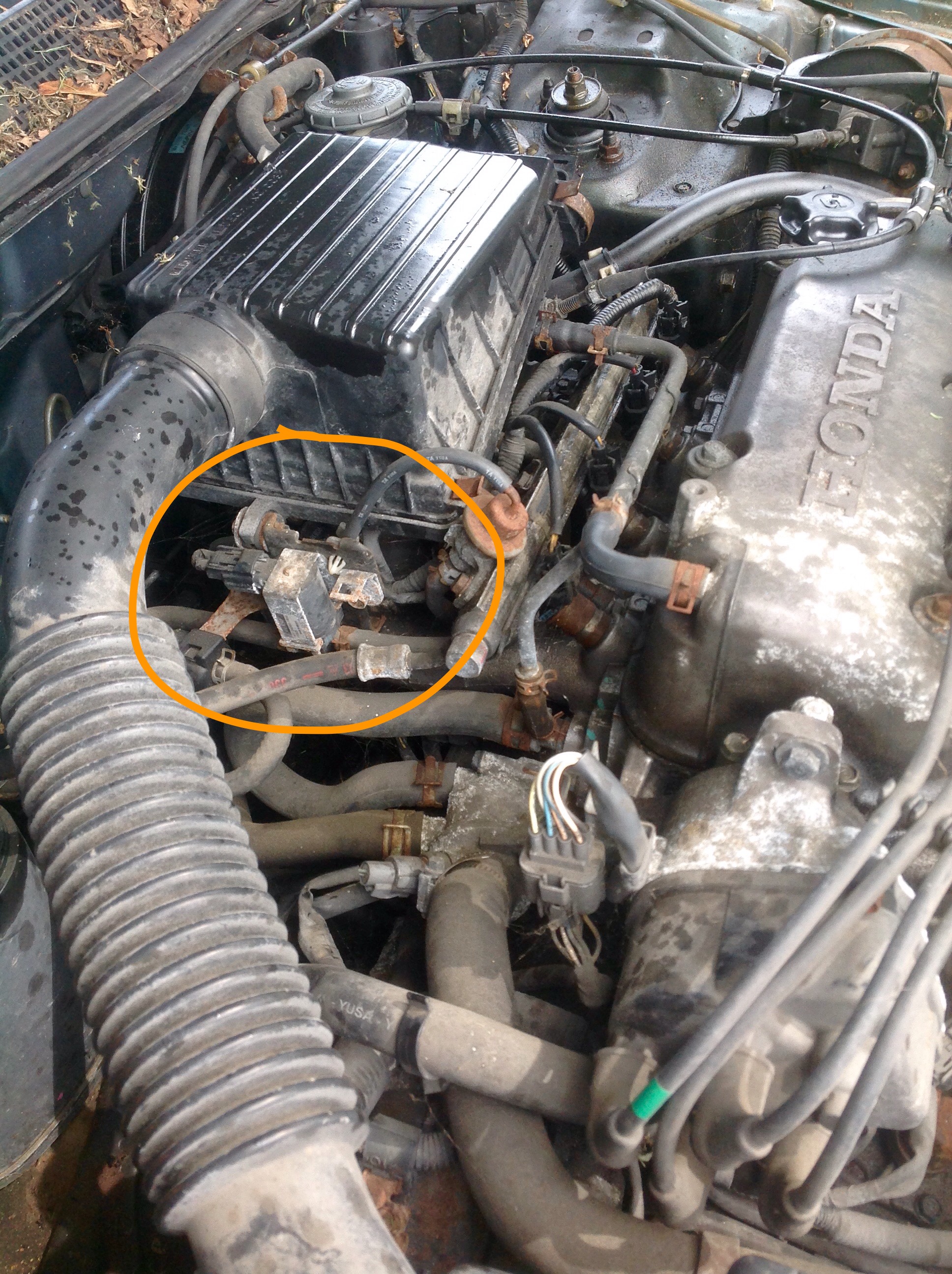

Is this the IAC?
Old Aug 8, 2017
Rep Power: 518
Re: Oil leak and Idle issues
IAC is part #2
Old Aug 12, 2017
Rep Power: 518
At about 1:10 you stuck the light up against the firewall and lit up the back of the filter box and throttle body.....Stick your phone back there in about the same place (or a little lower) and take a pic under the box, maybe you will see the hose clamp that has to be loosened
