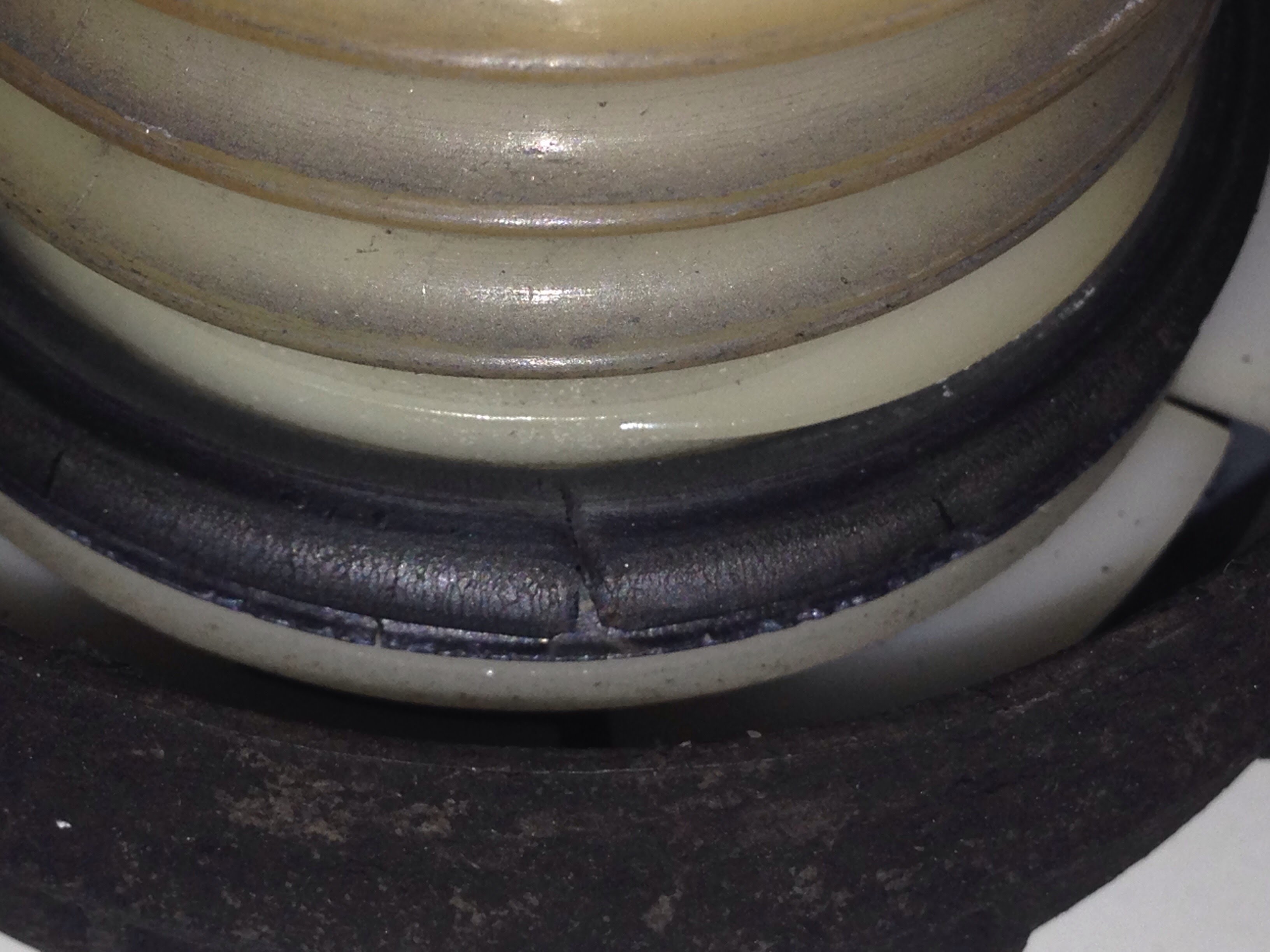

I did check the gas cap yesterday when I filled up- the o ring is shot. They are 10 bucks. Figure I can start with cheap fix before I dump 160 into a new purge valve.

Been a couple of days, armed with a new gas cap with about 1 to 2 drive cycles And... I'm keeping my hand away from the shifter (a serious conscious effort!)
no !!! Good stuff!
The O ring was a bit... worn. The cap itself has the original "Honda MFG" label.
