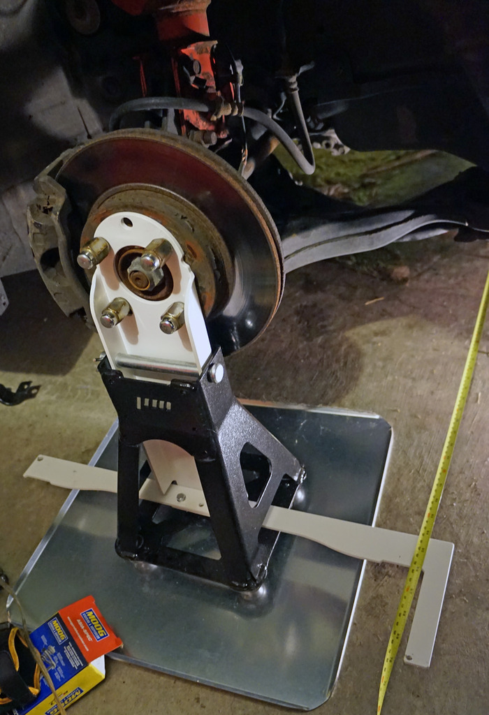

hub stands from flyin' miata are the cheapest (great for home alignments) but still expensive.
you could make steel plates with grease in between, and 4x4 to lift the car a little for clearance to torque them, though.

Ohhh Sdaidoji those are sexyyyy!
When I did mine I had the car on jack stands then use a jack to put pressure on the control arms to force the wheels to ride height.
