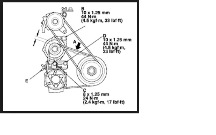

Ok so I found this:
http://imgur.com/a/NbKYp
and this:
http://www.gates.com/products/automo...elt-wear-gauge
I'm ready
Old May 24, 2017
Re: My Engine Squeaks
Aw hell I linked the wrong year diagram LOL
Sorry

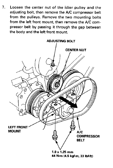

I found instructions on how to remove the power steering belt
The Alternator Belt
The only belt in the way is the A/C compressor belt and I can't find any information.
The manual says to loosen the big golden wheel.
Any advice for me?
Before you commit to buying stuff, tighten up the alternator belt so it will STFU and you can drive the car without having dogs howling and people staring as you drive by.
In your 2nd video, the kid only appears to loosen the top bolt of his alternator....and presto, it is free to move! That means the bottom bolt was never tight at all. Bad bad bad.
Reach the bottom bolt through the wheel well. 14mm wrench.
As long as that bottom bolt is tight the alternator won't move. You gotta loosen it too. And tighten it when completed.
Also....on the top alt bolt I use a regular wrench, I don't try to stuff a ratchet and socket in that narrow space.
You might need to use a pry bar for leverage to move the alternator, and you may need to keep the prybar in it while tightening the upper bolt because the belt will be trying to pull it back. Yes I use the prybar and the wrench all at the same time, from above.
AC belt uses an idler/adjuster pulley. Loosen center nut #19 (14mm wrench?) maybe 1/2 of a turn so the pulley is free to move, then spin the adjustment bolt #17 (10mm socket/long extension) to move the pulley up or down as needed.
Tighten nut #19 again when you reach desired belt tension
If you are replacing the AC belt you will have to remove the mount bracket under the frame horn in the wheelwell because the leg of the mount sticks through the belt.
