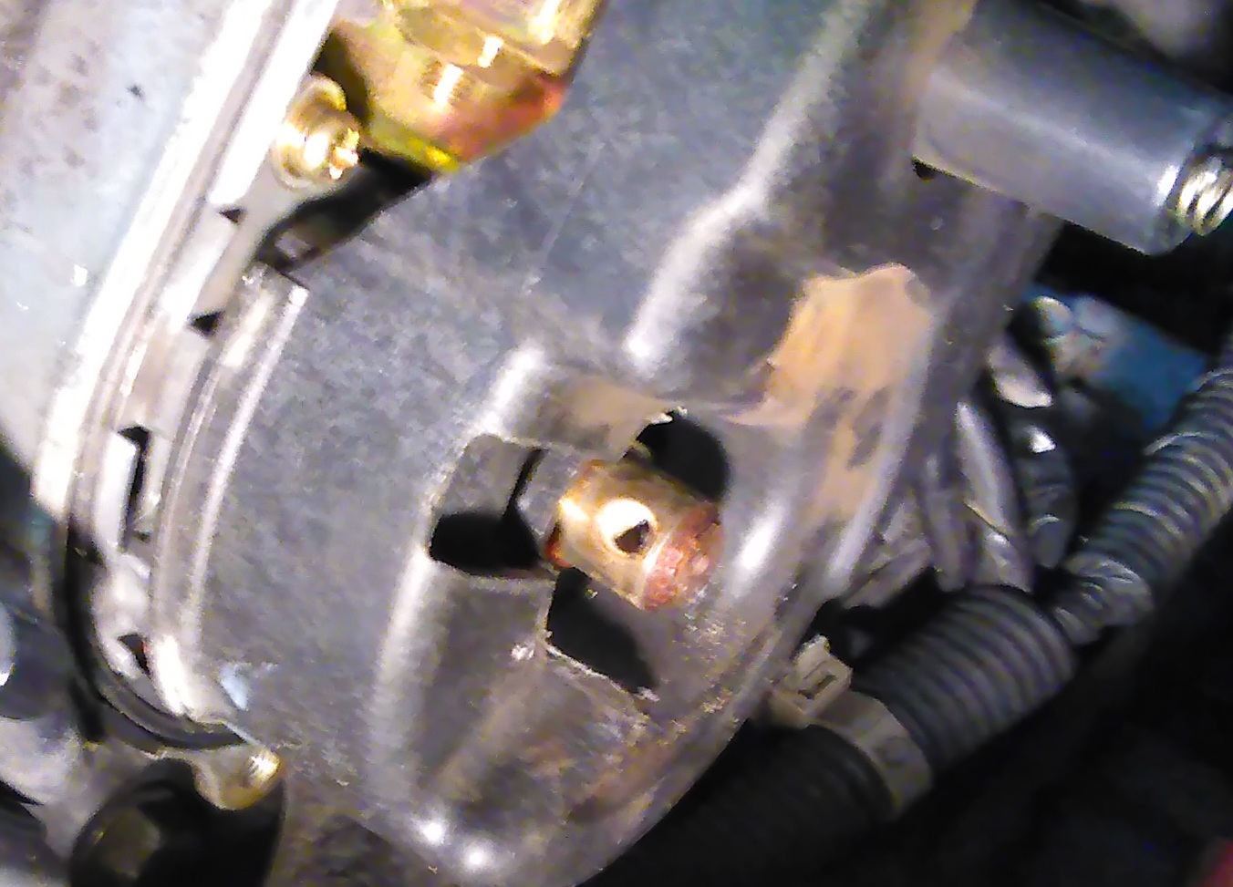

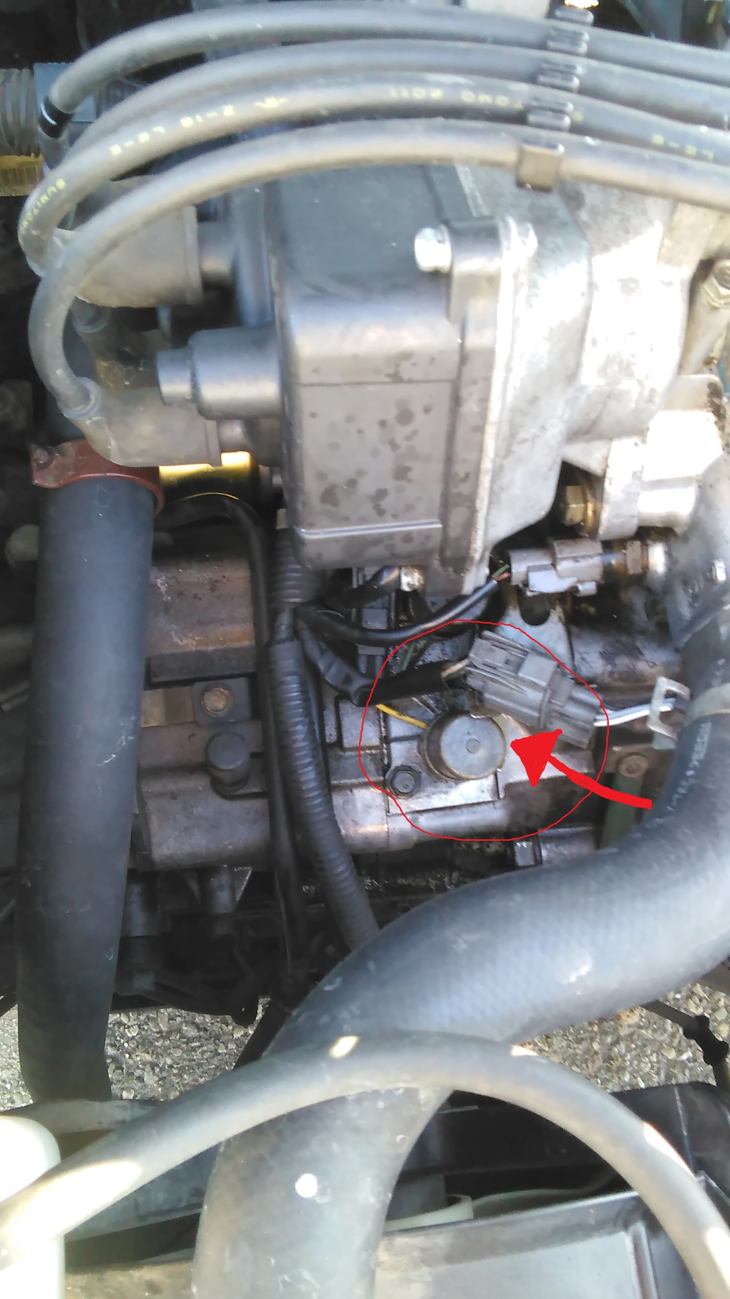

Hey friends,
I just inherited a used 1999 Honda Civic LX sedan. It had an overheating issue before and I suspected a leaking headgasket. Well, I just recently replaced the fan switch, thermostat, bottom radiator hose, and added new coolant.
It ran good after that, no overheating issues.
Eventually, though, the car started having trouble starting up, it would crank but not start over. So I replaced the starter and went to replace my spark plugs and noticed burnt oil residue on the plugs. I thought it was a leaking valve cover gasket so I went to replace that. When I popped off the valve cover, it was covered in sludge, it looked like mud. So I thought, ok, the headgasket is busted, but the leak wasn't much so I bought a bottle of 32oz Blue Devil Headgasket sealer and flushed all my coolant out and replaced with distilled water and the sealer.
It has been about 70 miles so far since I applied the headgasket sealer. Everything drives well, starts up fine. Although my car still has trouble starting over. I would start it up and it would act like its going to die, then "revive" itself back to normal. I just think its because I am currently running near empty on gas. But if I cold start it, it would start up just fine.
Well anyways, I was doing my usual inspection for leaks and I noticed fresh oil on a mysterious car part located behind the radiator just under the distributor cap.
I wiped it off and I would notice oil leaking back out. I can't exactly pin point the location of the leak, I saw no cracks. I'm hoping its just a loose bolt that I need to tighten or a worn gasket that needs replacing.
I thought I'd ask you guys since I cannot ask Google because I do not know what is the name of this part. I did a quick google search trying and the closest I got was "transmission" but the oil is leaking through the part connected to the "transmission."
I attached a link to the picture of the part I'm talking about, the oil is leaking where the red arrow is and pools just at the bottom.
I would appreciate your help.

Most likely the distributor's (external) O-ring leaking. Inside corners of valve cover gasket is another possibility. Also, open the the cap and rotor and inspect for oil inside... there's also an internal rubber O-ring that can that prevents oil from leaking into distributor which could cause misfire if oil is getting in.

The circled item would leak ATF if it were to leak, so if you find engine oil there it must come from somewhere else above the circle. Distributor seal(s) would be a good guess, or you could do more sleuthing to pinpoint a source.

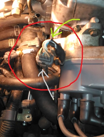

After reading your post, I set out to further inspect the location of the leak and followed it up to the corner of my VC Gasket like you suggested and lo and behold, I found the location of my leak! I took my cover off, cleaned it off with a carb cleaner, let it dry overnight, went to my local auto shop and bought a Permatex Ultra Black Gasket Sealant, applied it to the four corners of the gasket's humps, put the cover back on, torqued it to specs, drove for a day, and what do you know, the oil leak is gone!

Thank you, I found my the source of my leak after sleuthing around for a bit and it was indeed above the location of where I originally found the leak, at the corner of the humps of my valve cover gasket, there was oil all throughout the outside. I took the gasket off, cleaned it, and put it back on along with an application of a silicone gasket sealant. Everything is dry now, thank you.

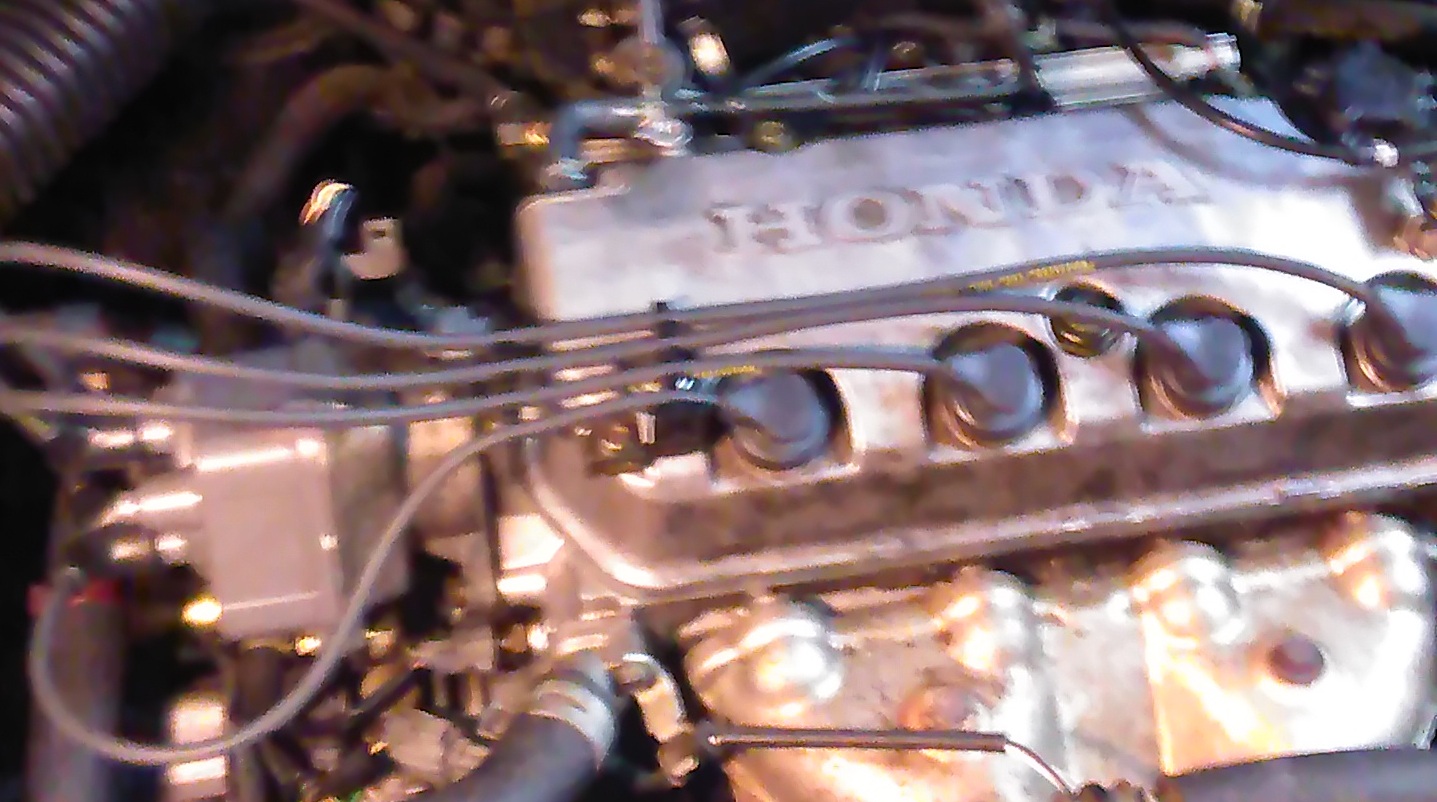

Here's the finished product, the reason I am posting this picture is because I would like to ask, are my wires suppose to be this long, the wires that were originally on were definitely shorter than these.

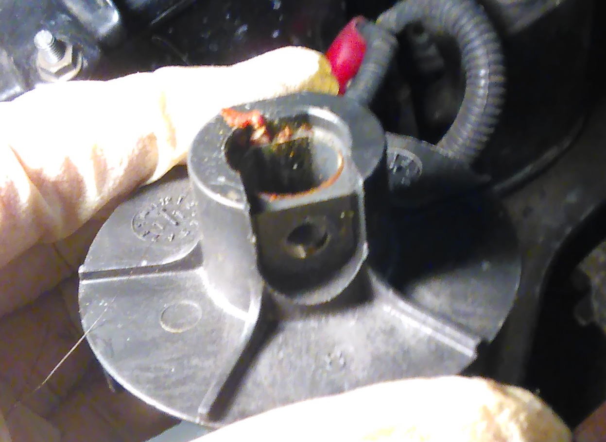

When I took off the Distributor Rotor, it would not come off easy, I had to hammer it out. It turned out there was some gunk keeping it stuck on, it had the consistency of wax. What is this stuff?
Here is the gunk on the Distributor Rotor connector. Do I need a new distributor?

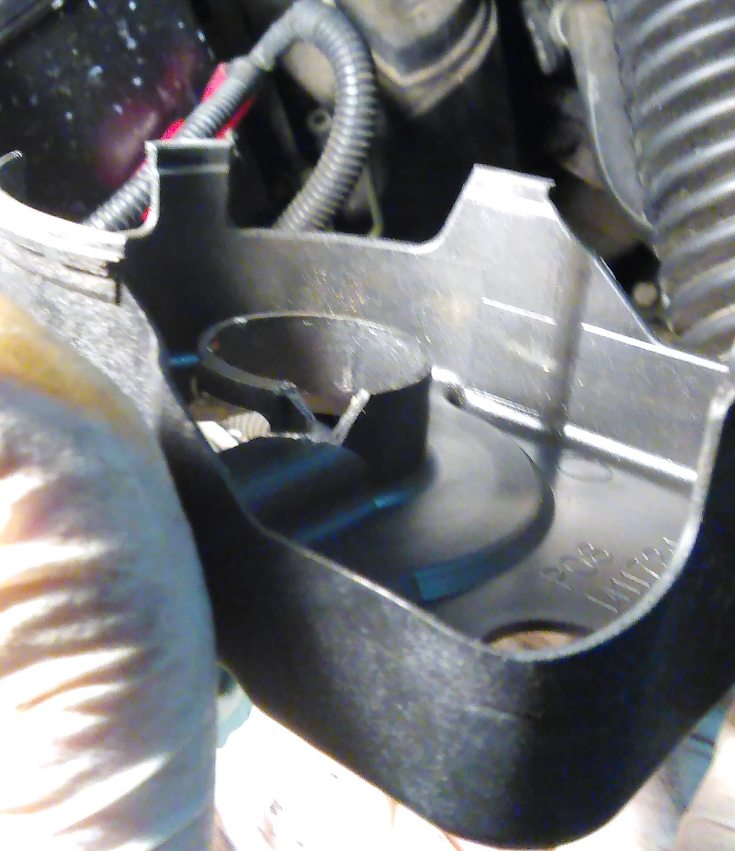

My Dist. Leak Cover is broken. I hope my dealership has another one in stock. I am going to this one on for the time being, or should I just take it off?

Wire length is not real important, just tuck the excess out of the way so it doesn't get caught in anything. Aftermarket sets are often designed to fit more than just your specific application, thus extra length to accommodate various engines.
Goo under rotor, possibly old and hardened grease. Does it wipe off?
Not an issue IMO if the new rotor fits ok.
I would not worry about the small crack in the plastic shield (cover) either.

An OEM dist cap usually came with a new rubber O ring style gasket to go around the base, helps keep it water resistant. Did yours?
