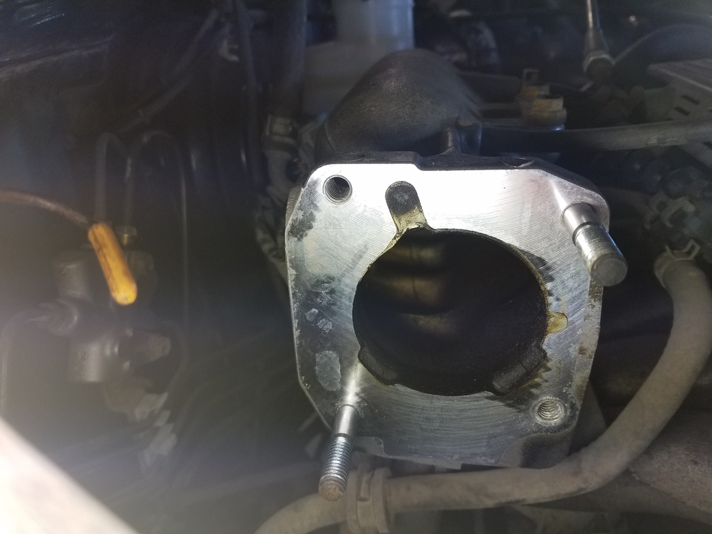

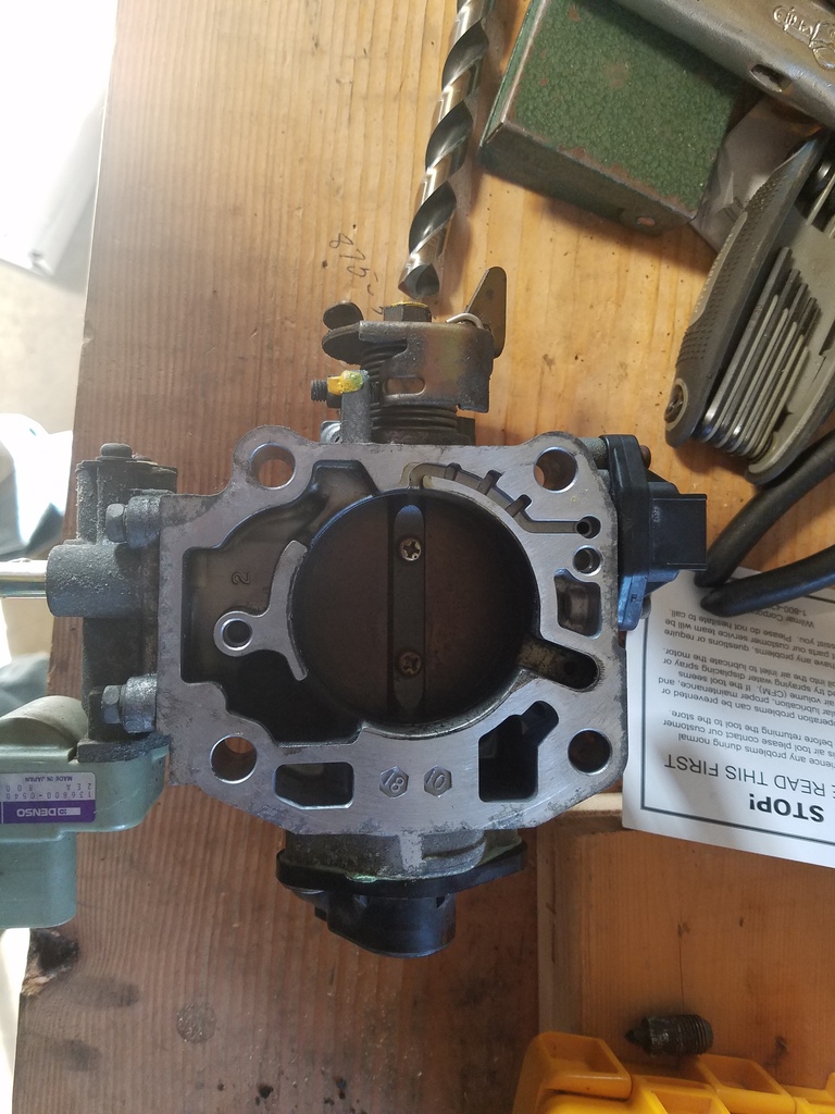

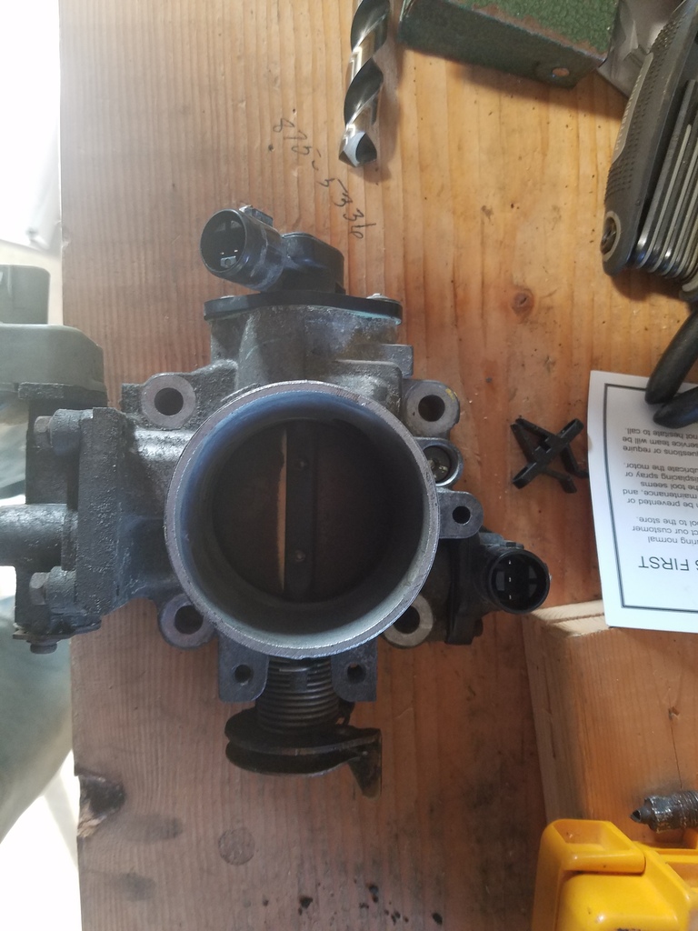

lol i seen that they did not want me to take off the TPS when i seen the way they mounted it. but the TB does not look that bad:

Looks dirty. The buildup around the edge where the butterfly has to close is where it needs cleaned. Google how to clean throttle body?
Don't forget to clean the IAC and the air bypass screw passages too.
