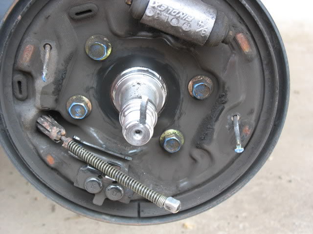

well like the title says im running into more problems with this car now its the wheel cylinders both cylinder bolts are completely stripped. i have tried lock wrench, those special rachet set that suppose to get stripped bolts off. only thing i think i can do now is either use a air hammer with chisel to get the heads off or to take the hole plate off that holds the wheel cylinder on and use a cutting wheel. the pic below is a pic i got off the net but i still have the wheel hub and abs sensor installed. any ideas? can i just take the plate off or is there more too it.

Maybe try PB blaster on them and let it soak for an hour or so.. then tap the heads with a hammer..then vice-grip again. Heating them with a torch may work too but, maybe not adviseable considering brake fluid and rubber. My guess is that Ezone has run into this situation a time or two and has some advice.

Depends on the situation. I have several options... 20k RPM+ carbide burr bit, cutoff wheel, torch, induction heater.....
Might be able to cut heads off without removing the backing plate, or might unbolt the plate and cut on a portable bench so I don't have to mess with the brake cable.... It just depends.
Wheel cylinder is cheap, do you need to save it or is it trash already?

well i don't need to save the wheel cylinder so took the back plate off only thing is now the abs bolt is rusted stripped too so now im just going to get a cutting wheel for all the bolts and just in case i need a new or slightly used back plate what is the tech name for it so i can look it up. and here is where im at right now:

well finally got the damn wheel cylinder off but kind of ****ed up the back plate and the abs sensor too so im going to get a new one and one for the other side because i know the wheel cylinder on the other side is bad to just hope i will not mess up the abs sensor. thanks colin for the part number they are only 35.00 a piece so that is good. so i will just go by my local honda dealership tomorrow. i just need to know that the bolt size for the wheel cylinder and the abs sensor, thanks.
