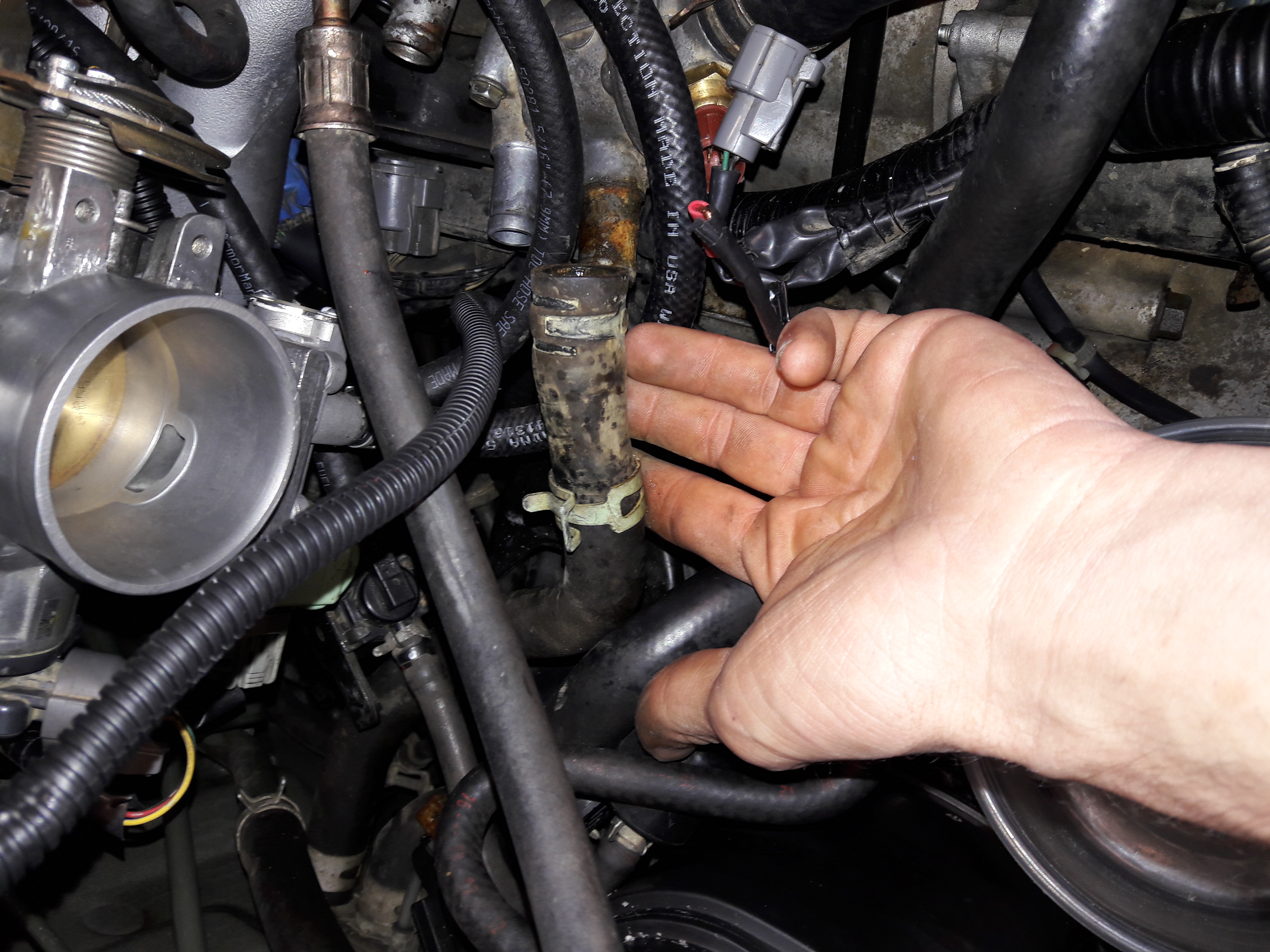

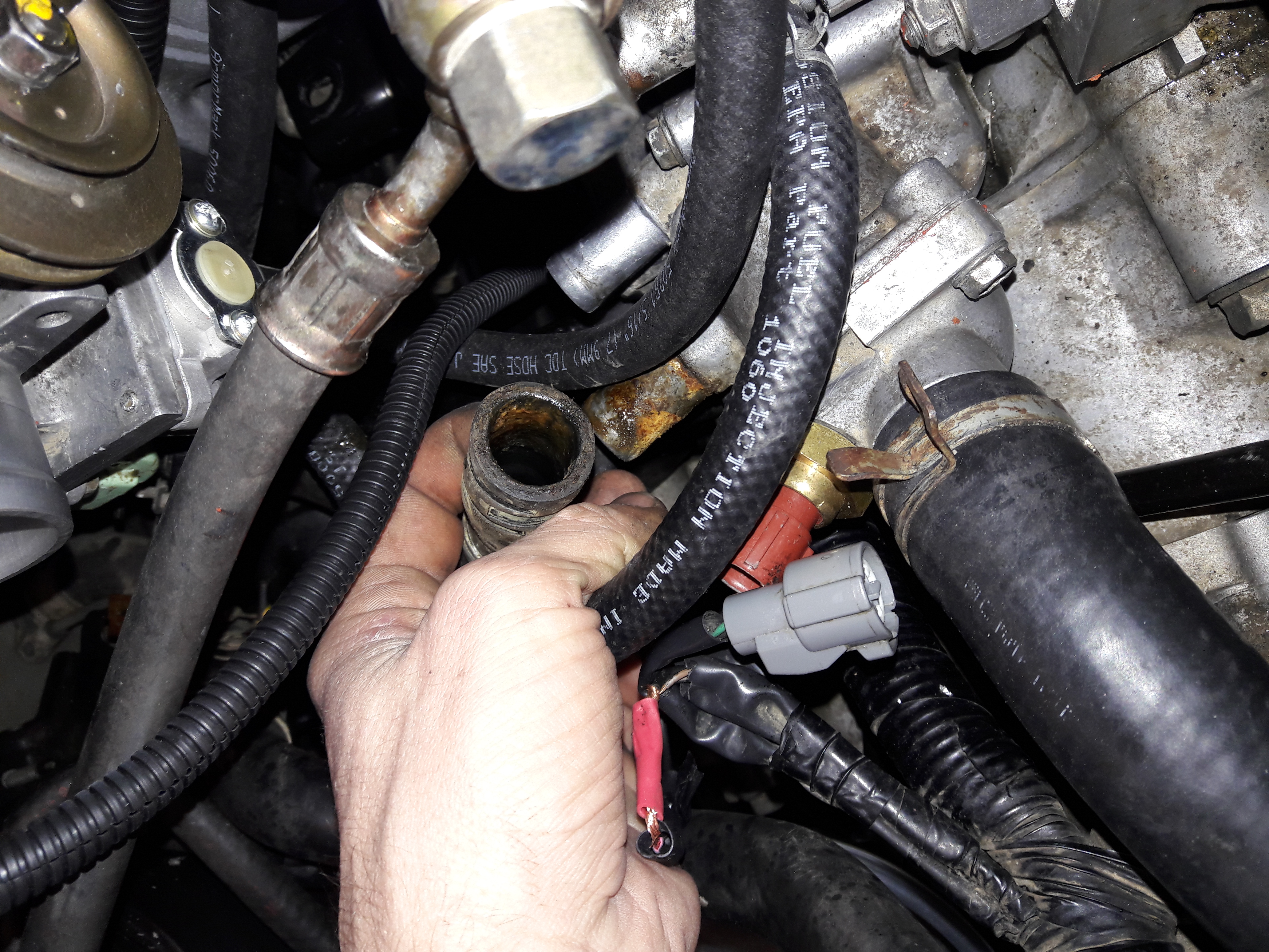

working on it as we speak...lesson #1 for me...don't neglect the heater hoses.. #2 NO ADDITIVES!!
Sorry EZONE 2000 civic lx sedan Auto check clears tomorrow...2500 to play with just gotta keep d series alive until then

The fitting that hose came off of looks covered in rust....a bit of emery cloth sanding could be in order. If it's pitted really bad maybe a thin coat of some RTV to fill in pits?
Those small hoses that say 'fuel injection'...are those carrying coolant to the throttle body? The hose material may not last a long time in the cooling system, and the spring clamps may not fit tight enough to stop leakage... keep an eye on them.

those are temporary until i figured out how to "neatly" run all the hosing..
calling it quits for the day to google more stuff and drive myself crazy over this car...all old heater hoses are gone and new ones installed..theres one in particular that has too much of a crease for me to be satisfied with...i bought 8 ft of this hose lol and was charged for 3ft (buddy @ store) maybe its new and hasnt set yet - i dont know....but on that note anyone have a picture available of their own routing system with these hoses..y7motor y8 intake manifold...going crazy here
