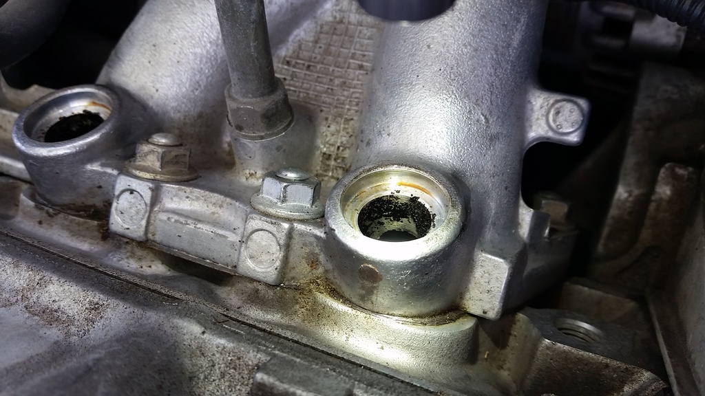

So I removed the O2 sensor on top and the cat looks new. Sigh, I'm all out of ideas. I even swapped my injectors thinking that one was not putting out enough fuel for some reason, but that didn't work. I found a massive amount of oily dirt in all 4 intake manifold fuel injector holes. How the **** did that get there? It didn't go through the seals.
It's normal, I wouldn't worry about it. The injectors can't spray up that high to clean it off.
but when the engine gets hot it feels like there is a bottleneck.
What about when cold?
