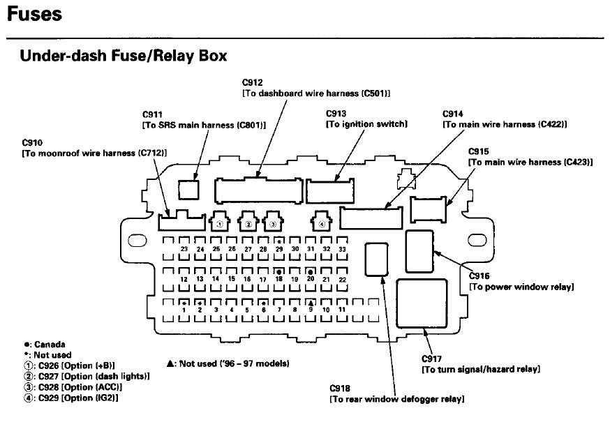

Any advice on a good way to go about it
Not really, just follow the bulletin if that's the problem.
Do you mean a 15 fuse or #15 fuse on the fuse box cover?Thanks.
Position 15, the box I believe may be labeled if you look real close. IDK what the amps on the fuse are. (EDIT 7.5a in the image)
Goggle Image Search:

Re: No power to Oxygen sensor
I seriously appreciate the reply and pic.I figured out my #15 fuse was toast and I replaced it.I reset the ecu and and all the codes disappeared and have'nt come back even after a long test drive.Before,the check light would come on 10 seconds after starting but not anymore.My speedometer still does'nt work so I'll look into that.When the key is in the off position the speedo reads zero.When I turn the key to start it then reads 20mph.If the dash speedo was bad would it do that?I have the feling that it is the vss and think the dash MPH would'nt read anything if it were bad but I'm not sure.Any advice or input is truly appreciated.Thanks.
