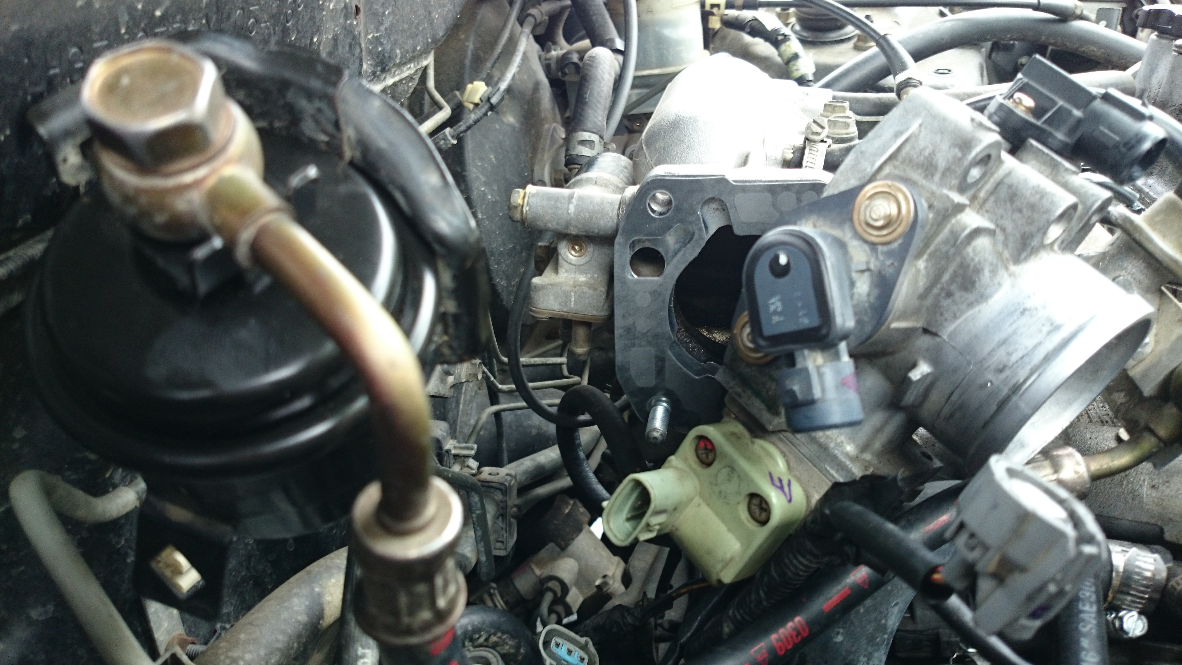

Does the throttle body have one upper port or two? If that original IAC valve on the back of the manifold were sticking open, is there a passage in the throttle body that can feed it? I see the hole in the manifold, but what about the TB?
Oh crap that's a big pic.
I don't remember if I mentioned this one on your other thread..... Crank this screw in a turn or two and see what happens? (Make sure to note the original position so you can put it back if you have to.)

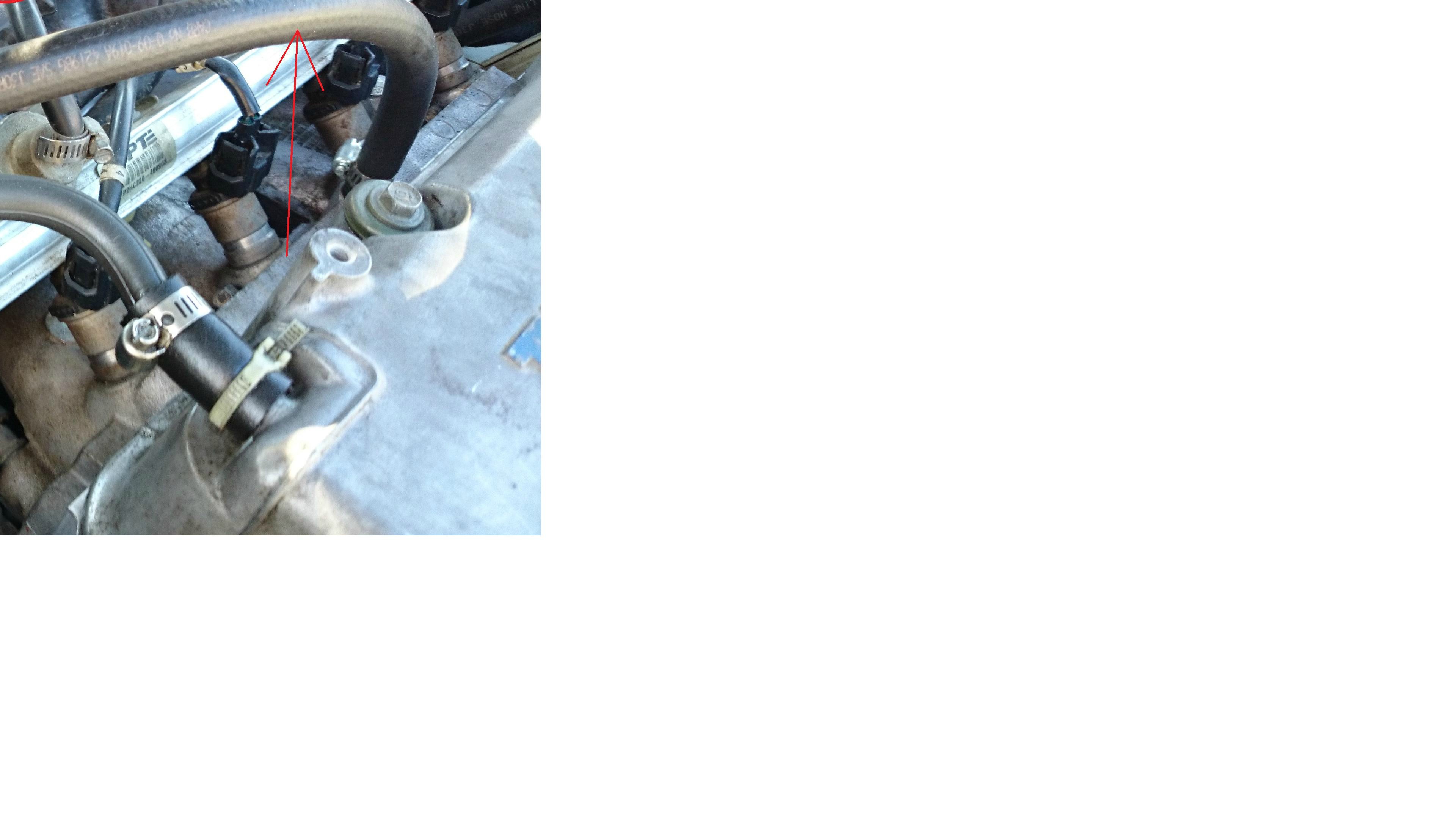

That fat hose (red arrow, pic below) that runs between the injector area and the intake snorkel, pinch that one off and see if idle drops.

I took the intake off so I could get at the wire carriage that goes to the IACV. It's buried under the intake:

I DID notice the nipple (labeled "B") for the hose at the center of the injectors goes to atmosphere? There looks like no coverage by the IM gasket....so the hose is irrelevant. It's not a vacuum leak, it's an unfiltered air leak into the big air tube IIRC. Would this be a correct assumption?

Can I buy the correct plugs at O'Reilly Auto or do I have to get them at Honda? I don't think you can buy any of them with money. I have saved every wiring harness ever replaced over the years just so I can steal connector shells and pigtails like that.

it seems the ECM may have been swapped in this car. The unused manual trans IACV has a round, 2-pin connector, presumably w/ 3 wires. The auto IACV has an oblong-shaped 3-pin connector w/ 3 wires. I was looking for a splice from 2 wires to 3 under the intake, but I couldn't find one. I unwrapped all the electric tape and shielding from the wires and it's 3 wires to the IACV plug all the way down. Unless they spliced it way down into the cable tray, and I don't think they did as the cable loom is still intact, I'm guessing the ECM was swapped.

Took me a minute, but I see what you mean about the B hose vent to atmosphere at the manifold. I see what you're saying: it's not covered by the gasket, so it doesn't see vacuum. It doesn't appear to do anything. I remember when we first got the car nothing was connected to this port. Years later this B hose got hooked up, but that's been years past - I don't remember why. Maybe it really is useless... what's the point of bypassing the air filter w/ this air? I'll look through the manual and see if I can find something.
That's a bummer about the connectors. When I looked at the IACV connector and the others near it, all the wiring looked fine: no breaks, tears, melted plastic or anything. They could still be broken within the connector I guess. I'm more convinced than ever that it's a vacuum leak. I think I need to: fix the bad hose I described above, burp the coolant WELL, and relearn idle correctly. I think I didn't do so well on those last two things when I replaced the IACV in August.

"H" connecting the fuel return? to vacuum?
WTF why does it have hose clamps? Should not fit so loose that it needs clamps. Those clamps are way too big for that tiny hose. That can actually pinch the hose to create leaks.
Maybe this is why OEM stuff rarely uses these hose clamps.
Quote:
I waited a few minutes and lightly tapped my foot on the accelerator. The tach then jumped up and started surging. It kept doing so the whole time.
What WOULD that nipple be for? IDK, what's the manifold off of?

I went to the auto store and got a couple feet of vacuum hose. I replaced the "H" hose and left hose clamps off both ends.
https://i.imgur.com/68bJFD2.jpg

Since you tap the gas pedal to get it to start surging, makes me wonder if the throttle body has worn out shaft bushings allowing the blade to **** slightly crooked when there's vacuum in the manifold. Wouldn't be the first one I've seen like that.
Does the TPS voltage NOT return to the exact same value after you tap the gas pedal? when the idle starts surging?
How many miles are on this throttle body?
Can you grab the throttle shaft (the wheel where the cable is attached) and 'pull' it 'away from the direction of vacuum' and get the idle to go back to normal?
Got another ECM to try?
I wonder which harness the engine has? Is it for an auto or manual trans?
I wonder which ECM terminals are being used to drive this A/T IAC valve?

Quick update: I started it again, jiggled the TB shaft a little. No improvement.
Let me try asking a different question. When I did all this work yesterday, I disconnected the battery, clearing the MIL codes. Since I've gotten everything back together, the MIL has been off. However, while I was playing around, trying to make something happen when it was surging, at some point after it warmed up, the fast idle started. I'm pretty sure the fast idle started as soon as the MIL lit up. It's like one is triggering the other. What could cause that?
Fast idle = it bounces between ~ 1750 and 1800 rpm really fast. If I open the throttle or bump the accelerator, even if I do it hard, it'll immediately jump back down to 1750/1800 rpm really fast. It's like the computer doesn't want it to go away from that narrow window so it forces the idle to stay there. Does that help explain what it's doing?
Have not checked TPS position yet. Need to get scan tool. I don't have a multimeter w/ leads long enough to probe ECM yet.
Also, I tried plugging the underside of the unused MT IACV while surging and nothing happened. This may not mean it's not causing trouble though. The only way to be sure would be to block the ports off entirely w/ an o-ring or something.
