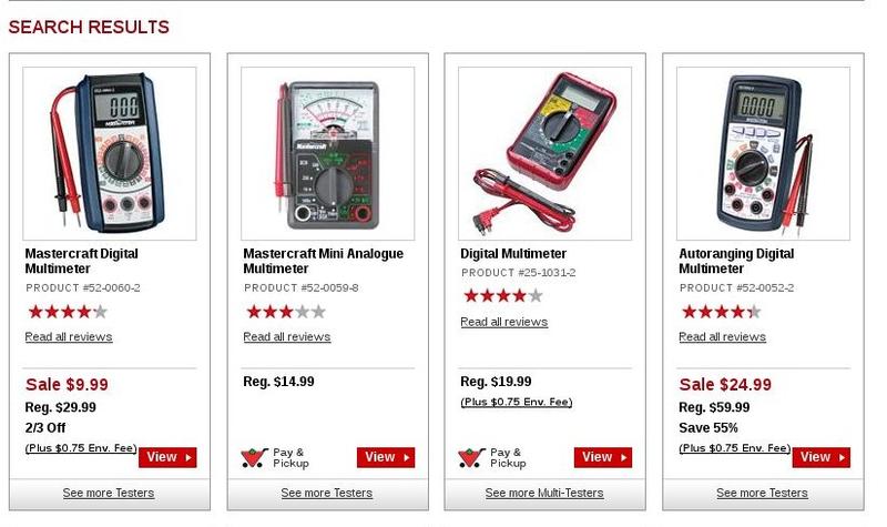

Canadian Tire pretty much constantly has multimeters on sale from $10 and up
