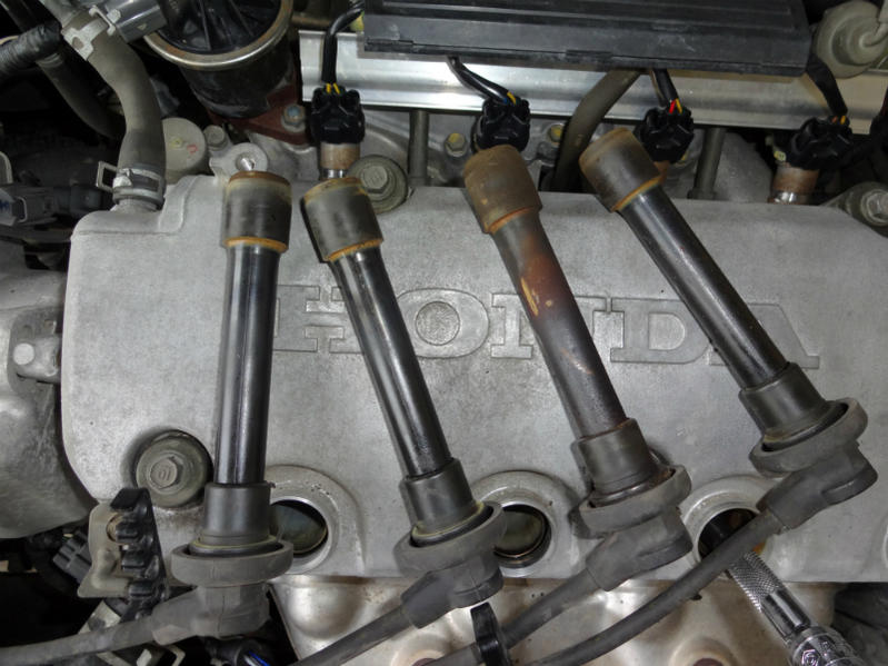

The wires APPEAR to be in pretty good shape, but I don't really know what's going on under the insulation.
Well, I guess I shouldn't try to do any more work in the dark. The 3rd wire from the right is in pretty bad shape. It looks like a roasted marshmallow. The end of it is kind of crumbling.
Here are some pics for your viewing pleasure.

Re: '98 HX 5spd; P1163 DTC with hesitation
Wire is probably ok, just dirty. Hard to evaluate any other aspect of it though from here.
Plugs look fairly normal ---- with an exception.
The one coated in black carbon was loose. #2?
The gasket was never flattened, it did not have a good seal against the combustion chamber.
Leakage comes up through the threads, leaving carbon deposits in the threads and on top of the plug and on the wire end, and in the sparkplug tube in the head.
A loose plug can overheat, and cause preignition ping/knock/detonation. A loose plug can't properly shed its heat through the threaded area into the surrounding head material.
I'd be surprised if the plug was not difficult to remove due to threads binding (known as "carbon lock").
Kinda looks like the others weren't fully tightened either, judging by the look of the gaskets.
Were they super easy to break loose? Little or no resistance? Felt like you didn't even need the ratchet for the initial pop?
No matter now.
Just make sure the new ones are properly tightened.

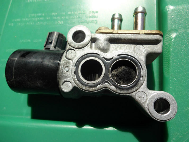

Today I cleaned the IACV, as it was looking pretty dirty (pic below). My car idles a little lower now, but it didn't have any effect on the sumbling/hesitation problem. I also sprayed the MAP with cleaner just in case, but it didn't change anything either. I took a peak into the intake manifold from the throttle body and it was coated in an oily residue, but it wasn't like caked up super thick or anything.
I'm not sure if you see something in this info that might stick out to you, but I just thought I would give an update. Thanks for all of your help thus far.

-The redundant ground is still in place, with no positive results.
-I inspected the fuel filter, because it looked pretty old. I replaced it with OEM because the old was fulll of nasty slime. No positive results (Really?!).
-Tested the spark plug wires. They seemed to be in spec, ranging from 7,000-11,000 Ohms depending on length. At least from what I've been told, that is in spec.
-Tested vacuum from brake booster line with cheesy looking AutoZone gauge. It was 17 Hg at idle. This seems a little low, but not sure how low is acceptable.
-Tested the ignition coil (not sure I did this totally correct), but it registered 1.7 when on 200 Ohm scale. I read that spec is 0.6-0.8, but it wasn't for an HX. I'm not sure if that matters or not.
My brother came and visited over Christmas and he had Dash Command on his phone. He had it hooked up while driving and when holding steady at 60 mph on flat road I was getting around 28 mpg. At 40 mph I can manage 35-36 mpg if holding the accelerator steady. It looks like it never enters lean burn at highway speed.
Anyway, hope Christmas/New Years was good for you (and everyone else reading). Hopefully this info will shed some light on the situation.

Alright, so it's been a while.
Wow, I about forgot all about what's been in this thread.
A rule of thumb I learned long ago was approx. 10k ohms per foot max.
If it isn't misfiring, they probably aren't an issue.
Ignition coil is either good or bad. If it makes spark of sufficient length, it's good. If it was bad, it would either run horribly or not at all.
See a spark air gap to kV chart to evaluate spark length.
If you backprobe the MAP sensor with the engine fully warmed up, in neutral, no electric loads, it should be around (ideally) 0.80-0.90v.
Have you done a valve adjustment?
Is the STFT still hanging in the double digit negative numbers?
Do the temperature sensors (ECT and IAT) reflect actual temps?
I think it has to see a very low load situation to enter that mode. Aerodynamics and rolling resistance come into play for that.
Do you have good quality tires on it? Low rolling resistance? Aired up?
(My fat tires killed all sorts of gas mileage on my car, seems like close to 20%. It does not roll easily, and it was very apparent the day I installed them.)
Hey, a new person in the shop just got a 99 HX and is currently fighting a surge and low gas mileage too. Over 200k miles on it.
It had a cat code, he bought a header and an under car cat from a completely different car, modded the O2 wiring to install them.
I'm watching to see if he comes up with any answers on his.
