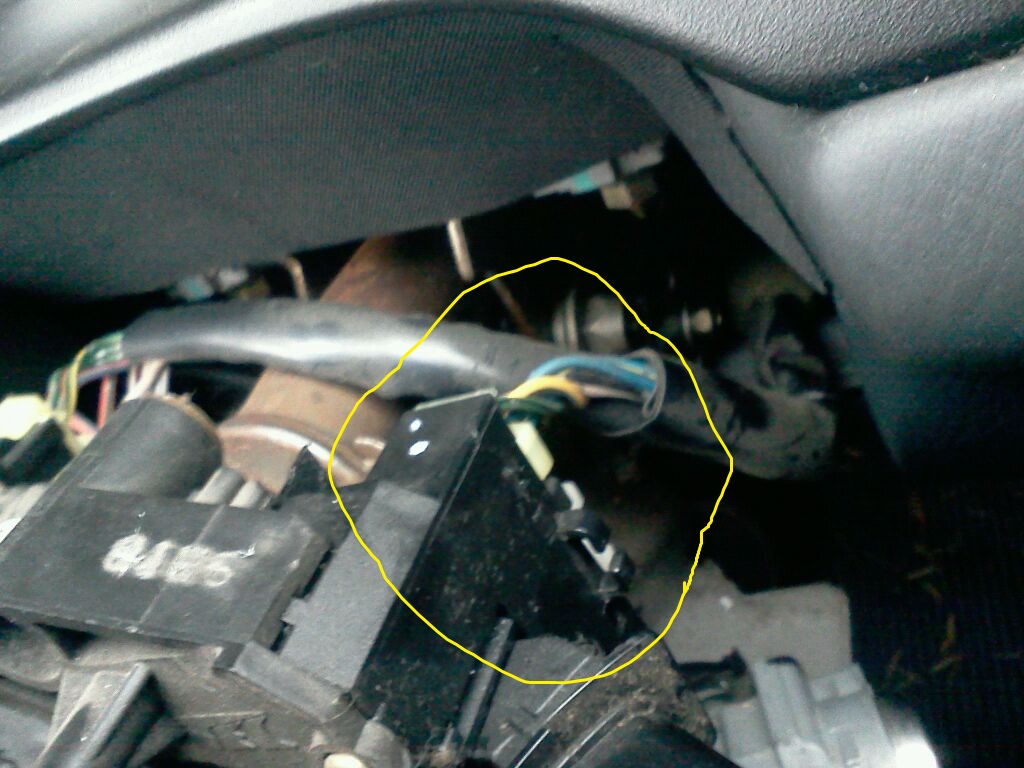

Okay so I got my civic back up and running after it was stolen. Just needed new air intake, battery and wheels. But as I went to drive it to work I noticed the wipers didnt work. I've checked fuse/wires then noticed something unplugged from behind the steering wheel, plugged it back in and now my squirt things works but still NO power to any settings for the wipers. Will I need to replace whatever part plugs in? or is it a wire somewhere?

if none of the fuses were blown then there is an open in the wiper switch the circuit connecting from power to the switch or and open ground wire. you will need a wiring schematic of the wiper system to figure out test the wiring and switch.
