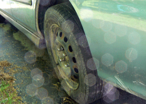

My 99 Civic suffered damage to the left rear wheel.
The lower arm clearly needs to be replaced. I'll put new bolts and bushings also.
The drum looks to be bent in a bit. Is that something that can be dealt with during an alignment?
-OS

Put the new arm on and see where the wheel/drum/etc., ends up.
Compare the bad side to the good side.
Do this before getting the rear aligned, and fix all that needs fixed before alignment.
Could have bent far more than just the obvious arm. Could be the knuckle, hub, axle stub, or the big arm (trailing link). All I can do is guess from here.
Expect the wheel bearing to be heading south soon. They don't take an impact very well.
HTH

Thanks, that's the plan.
I take it that I'll need a spring compressor when I take the arm off?
-Os

The spring is contained within the strut, so no.
