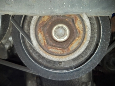

I can already see the rubber has disintegrated between the two pieces even without taking it off. there are a couple sections inches long that you can practically see thru. I'm trying to attach a pic so you can see what I saw.
Attachment 83366
That's a bad one.
