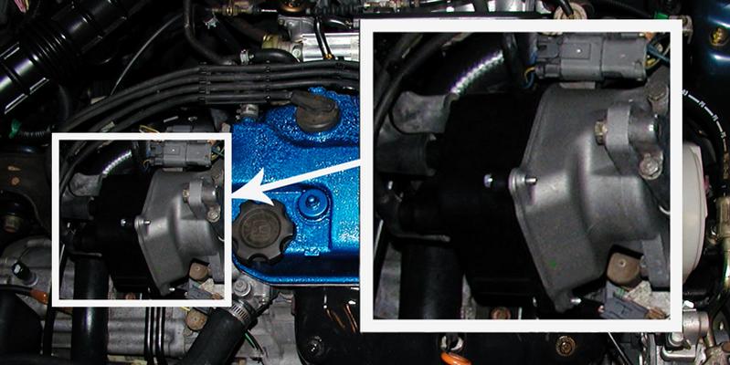

in addition to my latest post i have another question... does the ignition distributor come with the engine or is that a separate piece that attaches to the engine like the transmission... the transmission is attached to the engine but not a part of it... so is the distributor part of the engine or attached to the engine??> just curious...

Re: 94' Honda Civic Nightmare-- Overheating!
You are correct in the first post. The distributor is attached to the engine. It is the cylindrical thing to the left side with the plug wires coming out of it. Has 3 bolts holding it in.
