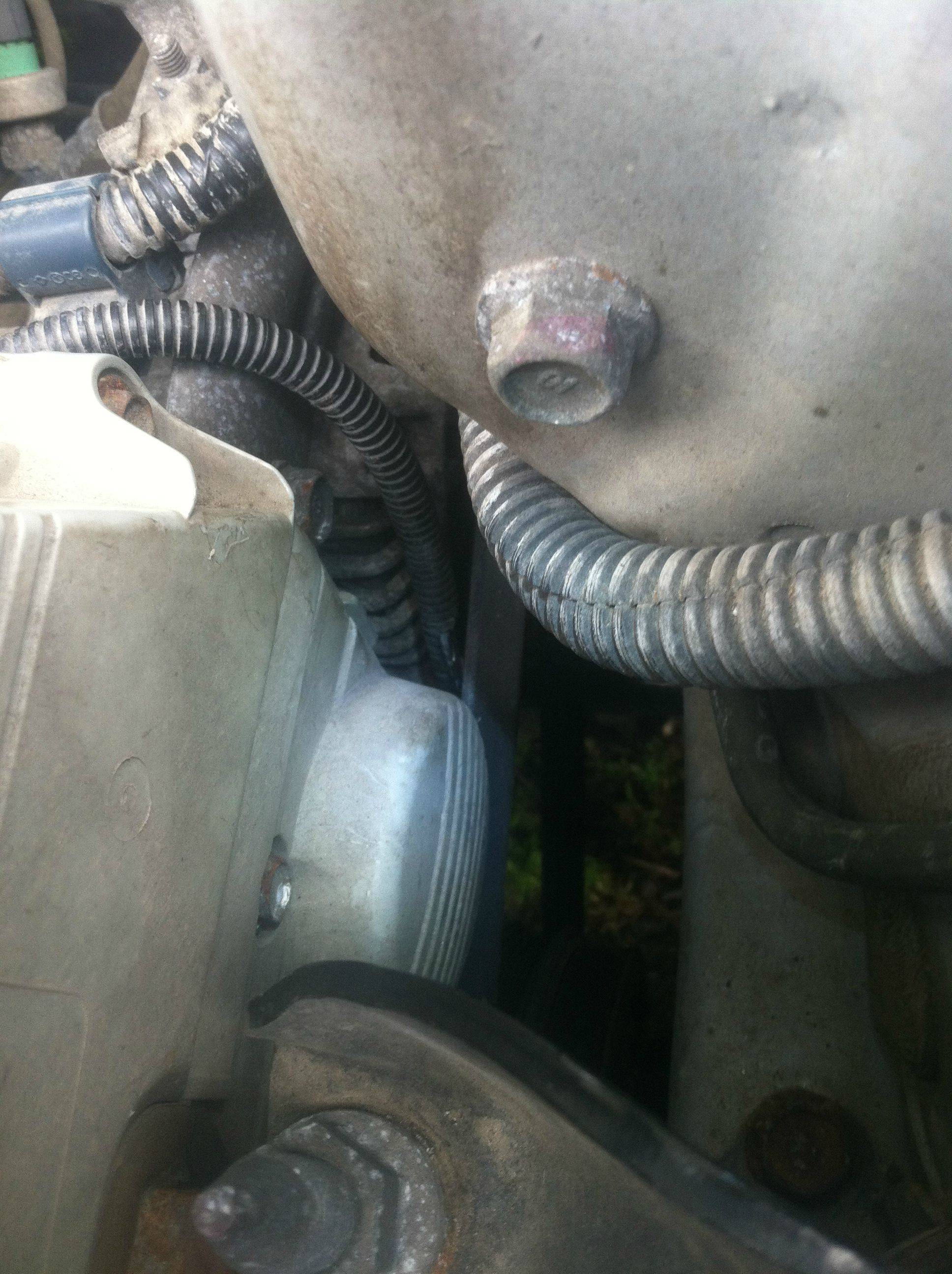

I did find a wire whose plastic cover was halfway sawn-through by the alternator belt. Any way I can fix this, or does the wire need to be replaced? I can't tell exactly how badly its frayed.

Yep, that's it. Some lazy SOB didn't tuck it back in,and you can see one of the little brackets that harness is supposed to sit in. The tabs are a molded part of the timing cover.
The CKP is item #14 here, if I picked the correct car: http://www.hondaautomotiveparts.com/...NER+%28SOHC%29
The harness you can see is part of the Crank Sensor (CKP) itself. You can unplug it up behind the alternator, then work it out where you can work with it, and see if you can patch it back together, or you can just replace the CKP sensor (the wiring comes with it). Remember to tuck it in to the little holders this time.

All you have to do is reconnect the wire(s) that the alternator belt cut in half. There are like 3 wires inside the plastic wrap. Splice it if you think you can, but it needs to be small enough to tuck the harness into the little holders so it doesn't happen again. And it needs to be weatherproof.

Late response, meh. Took it to Pep Boys, and they spliced the wires, taped them up, and ran them a different way (away from the accessory belts). No heat shrink tubing anymore though. CEL turned off when I disconnected my negative battery to put in a head unit (before taking it to Pep Boys) and hasn't come back on, so problem solved I guess, lol.
