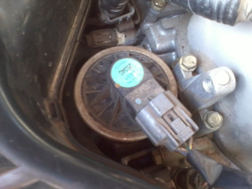

For the mis-fire: Service manual says to check EGR, check for good spark, and check the injectors.
EGR looks like this:

Lazlong, that got me thinking. The EGR's purpose is to cool the CC right? Is it possible that it's dumping too much recirculated gas and the spark plug can't fire properly?

^^ Could be.
FYI: A yearly top-end, EGR, and PCV cleaning isn't a bad idea.

LazLong, that picture looks to show the EGR valve next to the valve cover. I don't see it there, or on the intake. it's a D16y7 99, does this use something else?
Edit-- I checked the factory service manual, and it doesn't list the EGR solenoid. Every other model uses it but this one. Does this use that valve overlap setup for EGR? And if it does, would that cause the issue?
