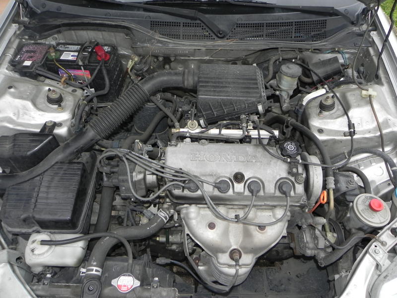

Im trying to recharge my AC but am unable to find the Low Pressure Service Port. Ive searched and all the diagrams ive found have either been for higher models or different generations. So i took a pic and am hoping someone can help me out here. Thanks

from that picture, it is hard to see any a/c parts...the lines would be right in front of the radiator...and you would have a condenser (looks like a radiator)
I could have sworn they didnt come with ac but it doesnt look like he has the hook up for one under his hood

take another picture of the engine bay...your first picture looks like you do not have a condenser beside the radiator...

According to this diagram it's right underneath the power steering pump. If it's not there then it was removed by the previous owner or was never there. It would be in no other place. Perspective is from the front-driverside.

In your pic it doesn't look like it's there 'cause you can see all the way to the splash shield.
