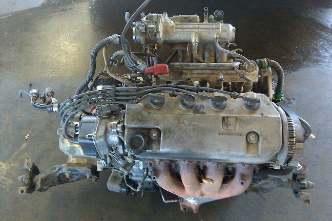

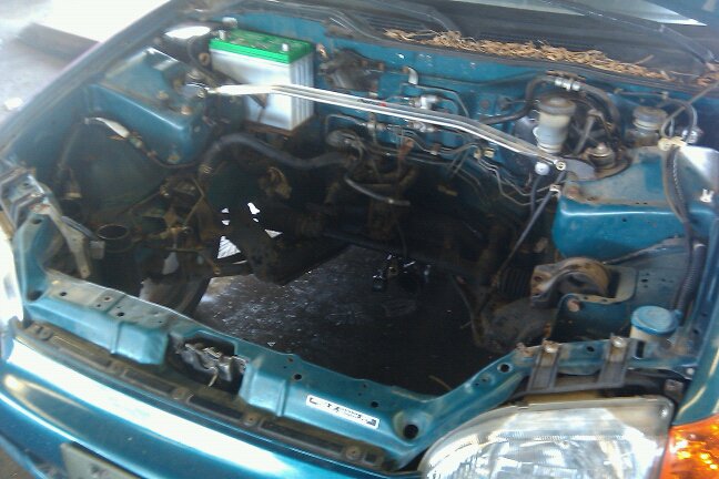

Same generation VTEC and Non-VTEC D-Series trannies are for the interchangable. I swapped a 8-Valve D15b8 Non-VTEC in a 1994 VX for a JDM D15B VTEC this past summer. Used the same tranny, no issues. Same applies for 7th gen, everything bolts up. Only difference, I believe, are the gear ratios between the DX/LX and EX. As for 6th gens, all interchangable.
