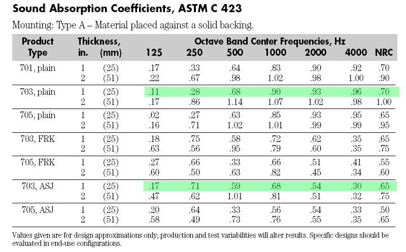

Here are some sound absorption coefficients for various materials... And the attached picture the two highlighted areas are plain and Aluminum backed fiberglass insulation... I've taken the difference of the absorption and the aluminum backing only makes a difference in the 250hz region... But the fact that you already have 2 door panels makes it moot... Not to mention the whole idea is to ABSORB sound, not reflect it... the only reason they have the aluminum on it, is because it withstands higher temperatures than plastic. In the original purpose of these materials they were meant to seal heat inside boilers, so aluminum was the product of choice instead of plastic. But when they applied this material to roofs and automotive purposes it became plastic because it makes a better water/heat/cold/temperature barrier than aluminum.
The 70X i.e 703, 705, 701 compressed fiberglass sheets are for home acoustical treatments, boiler liners, and duct lining (though honestly you don't really want fiberglass in a vent)... anyways, they have plain (no backing), plastic, and Aluminum backed. The only difference between the two highlighted ones, is the aluminum backing. You can see that at frequencies below 250hz (baritone singer) the aluminum will block some frequencies, but above 250hz it will substantially increase the noise reflected. these numbers are all percentages... so the difference (aluminum sheet) at 2000hz is -.39% meaning it's going to make almost 40% more noise than without it... The human ear is most "sensitive to the 800-2000hz range because that is the region where the human voice is (hence good reason to be more sensitive to it). So I reccomend the non-aluminum backed asphault sheeting.
________125_____250_____500_____1000____2000____40 00____NRC
Plain____0.11____0.28_____0.68_____0.9_____0.93___ _ 0.96____0.7
Aluminum_0.17____0.71____0.59_____0.68_____0.54___ __0.3____0.65
__________________________________________________ _____________
Differnce_0.06___0.43____-0.09____-0.22___-0.39___-0.66___-0.05
http://www.bobgolds.com/AbsorptionCoefficients.htm

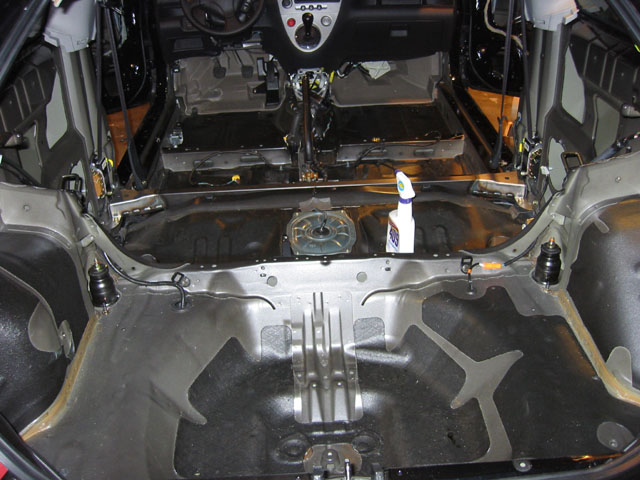

Originally Posted by 82801BA
I still don't know what jute is....Those ppl in Home Depot doesn't know what I was talking about when I was saying JUTE.....Any picture that will show it?

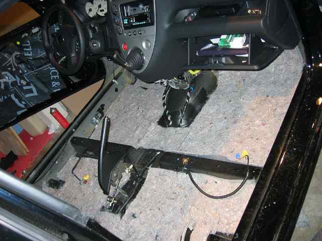

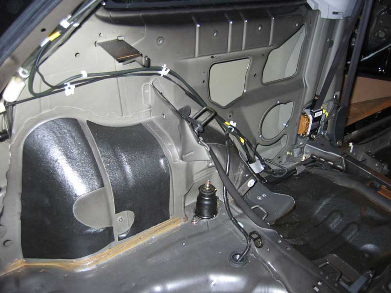

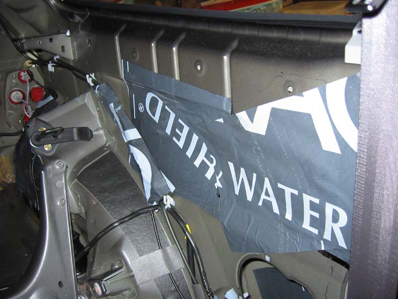

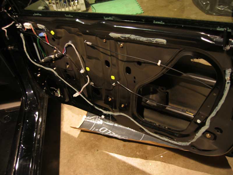

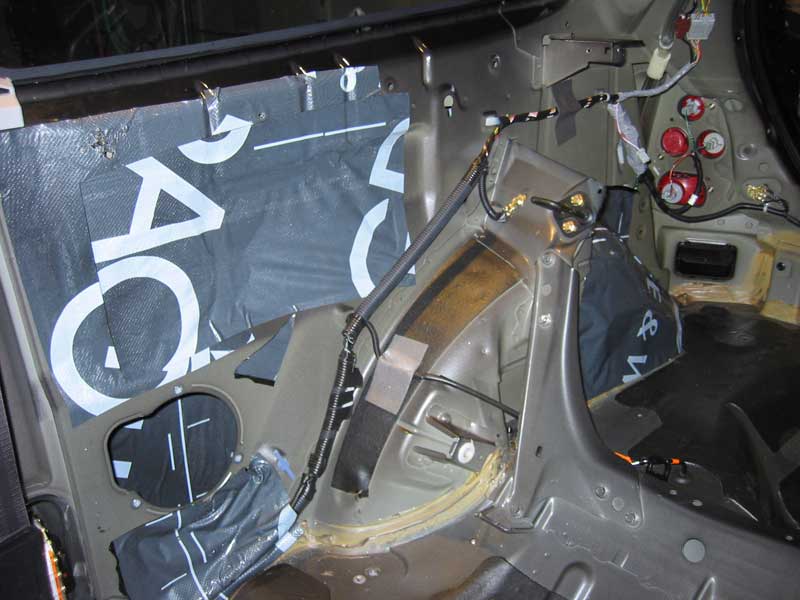

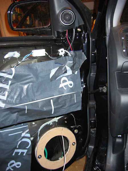

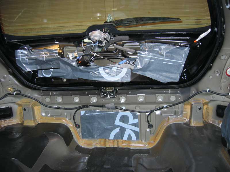

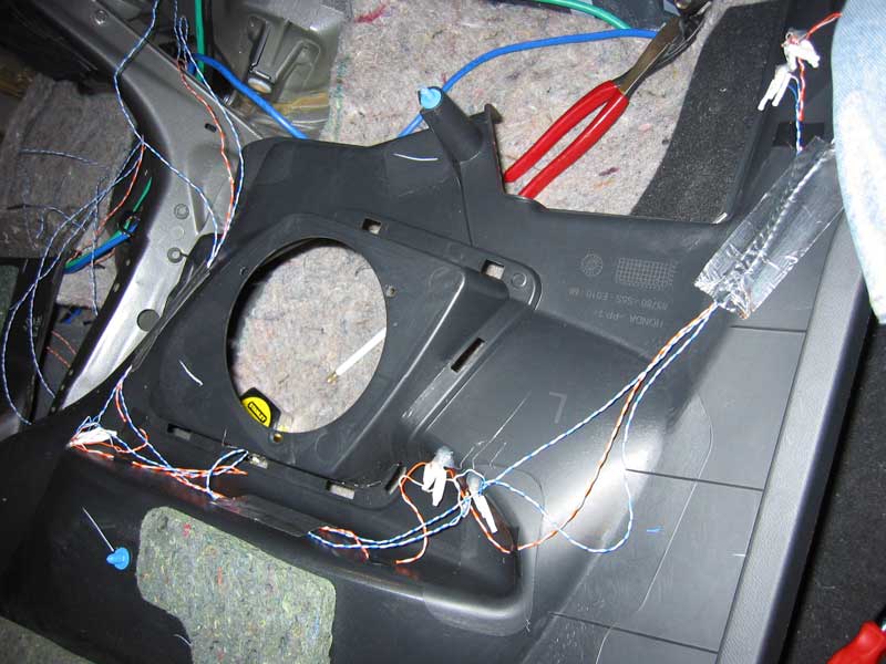

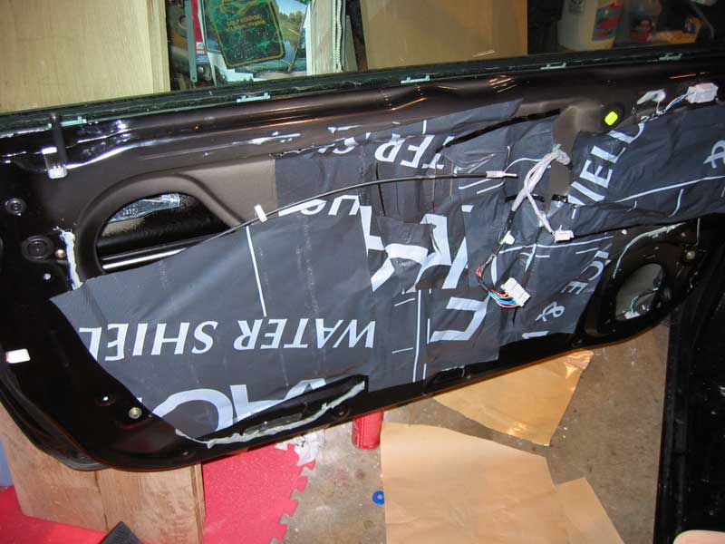

Yeah, I have some pics I've been meaning to upload. #9 and #10 are for you 820801BA. The rest should give a pretty good idea about howto install everything. They're labeled #01 through #14 and descriptively as well... I probably can get some more pics of it, but maybe you've seen it now and get an idea, it's kinda like those cheap army blankets that are grey and made out of lots of different weaves/threads...

The door has an inner shell and an outer shell. You can see the holes that go through the door. You seal all those holes with the asphault sheeting, and then the inner part (the part where the plastic door piece fits on) is water proof. There are still drains in the outter door shell where water leaks through. So as long as you put the jute basically on the backside of the plastic door panel, you're fine. The Jute is mainly synthetic materials from what I recall anyways, lots of cheap nylon threads. I have taken my door off many months after the first install, and the jute was completely dry, no mold or anything.
If you had read ANY of my posts before about using jute... people asked about the mold, and I had already said, only use the jute if you've sealed up your doors with asphault sheeting (that is what it's meant for, a water and ice guard, literally).
Posts: 1,047
so the water and ice goes on the outer AND inner metal parts of the doors??
in your pictures all u did was cover up holes?? i thought u put it everywhere to weigh the metal down?
Those pictures are not a "final install" they're all someway throughout the install...
Covering up the holes is an important part of sealing the external noises out. Air transmits noise, and especially in the doors, it makes a rear chamber for the speakers so air doesn't flow between the inner and outer chambers (skins per se)...
You basically add it on until you're satisfied that it's heavy enough not to resonante... I wrapped the door skins with my knuckles and you can hear the frequency that it makes go down as you add more asphault sheeting. I put some on the exterior panels (through the holes) and then covered the holes up and did a bunch on the door.
Do the knuckle rap (wrap?) test... if it makes a nice solid noise instead of a twangy noise... you're good to go. Imagine a saw, the old school ones you used to cut wood with... if you can imagine that sound, and adding weight to it, until it's resonating frequency is below a certain point, you have the idea of what you're trying to accomplish.

Ocelaris - you are a money saver man. i have an 04 coupe ex i just picked up and don't care for the road noise when i get on the freeway. 100.00 for materials including the jute for the flooring for a quiet ride is awesome! screw dynocrap. i rather by the same material with no name on it because in the end...you get the same result and keep your cash. awesome DIY man. this will be a project in the near future for me and has given me a direction. thanks much Ocelaris
Originally Posted by jameStype
i haven't read through this entire thread, but would you say its as quiet as the acura tsx interior or a standard luxury interior? i'm sure it will be hella of an improvement of what i'm hearing now.
Luxury cars as we know tend to be heavy and make up for it in bigger engines... our cars are more efficient, less power, lighter car... I don't want anybody to get their hopes up that they're going to instantly have a luxury quiet car, but you can probably cut the sound level inside the car by half. A little bit of work will make alot of difference.
Everyday I get into my car and appreciate less noise... took me 3 days of full work, but I did alot of things at the same time. Worth every penny IMO. I even convinced my wife to do the same after she heard the difference...
If you just did the doors and floor/rear seats you'd probably get alot of benefit. taking the headliner, rear quarter panels, and dash apart (in order of difficulty) will make improvements, but in diminishing quantity.
My friend's mercedes S500 has like 1/4" thick glass... (silent almost)
It's alot of work, but if you're already set yourself on sound dampening (dynamat etc...) why not throw some jute in there, make yourself a good seal with the asphault sheeting (i.e inner door skin and outter door skin) and then put some jute inbetween the panel and yourself...
I what I am trying to stress is the whole upper frequency part of noise reduction. Sure you could add 2" worth of asphault sheeting, but at that weight cost, you could have a sheet of jute or fiberglass which weighs almost nothing comparatively.
