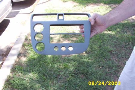

Old Aug 25, 2003
alex053's Avatar
Posts: 5,054
From: Peoria, Arizona, US
Rep Power: 339
here it is after..no line..all one piece, two din openings, primered and almost paint ready.,
Name:	dash piece.jpg
Old Aug 26, 2003
emajndat's Avatar
Posts: 120
From: Buffalo
emajndat is an unknown quantity at this point
sweet, but what did they use to fill in all the gaps...ect but it looks really good and perfect for what i need it for
Old Aug 27, 2003
alex053's Avatar
Posts: 5,054
Rep Power: 339
i used mar-glass for the large gaps....here are the steps i took
1. trace old instal kit onto 1/2 inch wood and cut it out, make sure it fits in the old hole
2. double side tape 1/4 abs plastic to the wood and router it so you have that same piece out of plastic now
3. measure size of radio so you know how big to cut the hole for the deck (i had a template for this thanks to RTTI)
4. double side tape the template to the abs, being sure its in the right spot in relation to the iso mount of the radio...if the hole is off nothing will line up
5. take it over to the pin router and cut the openings.
6. clamp your new routered abs plastic piece into the hole that once held your instal kit.
7. glue the plastic in using 2 part epoxy ( i used hot stuff found at www.installedge.com)
8. fill in gap using marglass and sand smooth.
9. primer, sand, fill in any pin holes with bondo
10. sand, sand, sand repeat then prime and paint.
it hink thats about it....im pretty tired and did that from memory..ill edit it or answer any questions.
