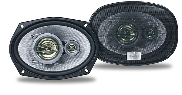

Hey Guys
I am having a bit of trouble here and need some help on this.
I went and tore the hell out of the back of the car last night in an attempt to put my new Kenwood eXcelon KFC-X698 6x9's and they will not clear the springs. ( Link to the Specs on Crutchfield ) . So in the end I put my Sony Xplod's back in and put it all together again.
I cant remember if anyone else had this problem or not, and what they did to fix it. I know I can put gas shocks in there but i am not sure I want to attempt that, I called Honda to see if I could upgrade to the Heavy Duty trunk springs cause I wasnt sure if I read they will give me the clearance or not, and they said it wouldnt.
I guess in the end I am wondering if I need some spacers or not and if so what size will I need for this?, cause I tried a few things last night and they didnt look like they would let me put the rear deck back in.
Please help me guys, I really want to get these in there cause they would finish off my Excelon system in the car.
Thanks in Advance.

I was looking at Crutchfield's chart in their catalog and found the Mounting Depth specs for you.
The car has 3 and 7/16" depth, and your Kenwoods have 3 and 5/16", so you have 2/16 or 1/8" clearance to work with. This ain't much, but it could work, theoretically.[IMG]i/expressions/face-icon-small-wink.gif[/IMG] But you said it wouldn't clear the springs. So much for the 1/8" theory.
Here's the real kicker though. The top mounting height is 7/16" height for the car, and 15/16" for the speaker. Therefore, you have a speaker that is 8/16 or 1/2" too high for the rear deck. This would keep you from getting the rear deck back on, unless you wanted to cut it up.
You're trying to force a speaker that is both too deep and too high for the car. Unless you want to mod the car to MAKE it fit, I'd suggest another set of speakers that have smaller dimensions.
If you plug in our cars specs, Crutchfield will give you a list of what is an Easy-Fit. It shows the Bazooka M690, Infinity Kappa 692.5i, and the Kicker 02K69 in the 6x9 size. If you look in the 6x5" size, you have 10 choices. I put some 6.5"s in there just for rear fill, since they fit easily and I'm using a sub for bass. If you're planning on getting a sub, getting some 6.5s makes more sense, and it'll save you from pulling your hair out shoehorning those exclons in there.

Thanks man, I am going to do some playing around on the weekend and see what I can do th make this work, a buddy of mine is really good with this stuff so he might be able to figure something out. Right now I have a Kenwood Excelon MP3 deck, Excelon 5 1/4's with tweets, the 6x9's (damm), and Excelon Subs. So I should have a good system all around but I want to keep it all Kenwood Excelon, so I might have to change what I put in the rear without doing some spring reworking.

Hey Thanks slick. I might have to look into doing that, if not I was talking to a friend who is real handy with cars and he said he would help me remove the trunk springs and put in a gas shock. But I might just look into a 6.5 setup as well.
