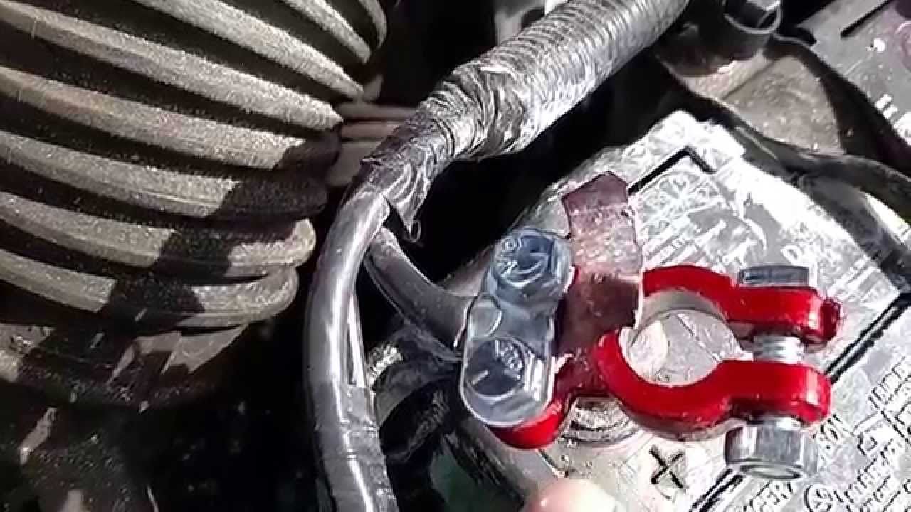

my immobilizer key, battery light, check engine light do not show on the cluster when I have it on the on position.
Does anything electrical still work?
My buddy wiggle.the battery post and all my lights pop on
Seems like this should be a clue to follow.
Cheezy clamps like this need to have the paint scraped off where it clamps to the battery post AND where the wires of the cable have to make contact. The point where the wires make contact with the clamp is a common place for poor connections to originate, often due to corrosion and oxidation.
Edit: forgot picture
