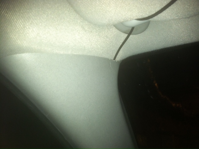

I have an Alpine Bluetooth system in my 01 and I ran my mic wire up to my sun visor through the A pilliar. You won't need to take the dash apart. Just remove the a pillar cover, no screws just clips, and fish the wire down the hole that is behind the cover by the dash. When you look under the dash from the driver side you should be able to see the light where the wire will be. If you need to you can tape the mic wire to a coat hanger or something and fish it from the top that way. I was able to do it without an extra tools.

Here is a pic of what I did:
Near the steering colume would be a nice place to put it.

Excellent responses. Thanks guys! I may consider the steering cover as suggested. Otherwise I did take off the A pillar cover just to see how easy it was and it was a snap.
GolNat, it's a bit tough to tell from the picture so I have to ask. Did you use a rubber bushing for running the mic wire out of the headliner? What you did looks very clean.

Thanks. I was trying to make it look like its suppose to be there. I used a rubber grommet. You can get them at Home Depot or Radio Shack. I would have liked to use a smaller one but the plug that plugged into the radio was big and I didn't want to cut the wires and re solder them. You will enjoy the Bluetooth it is a great feature to have (especially if you have a 2 hr commute). It's nice to be able to stream music and YouTube from my iPhone to the car speakers. The calling thing is nice also especially since its the law now in my state. Good luck with the instal!!

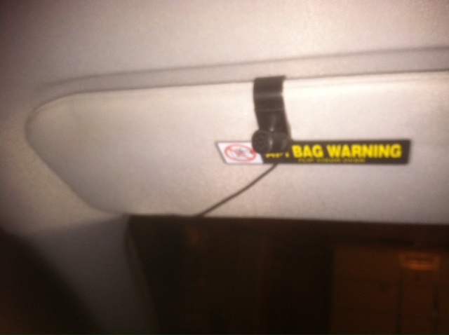

Installation went smoothly. Instructions provided by Crutchfield were excellent, but I also backed those up by DIY articles on here and a couple of YT vids. I must recommend Crutchfield for your radio needs because they 1) provide excellent instructions specific to the car, b) provide any extra hardware necessary for the installation at no extra cost, and iii) are already competitive with other vendors with price. Given all the extras, it seems to me to be a no brainer to go with them.
My biggest concern was with the "illumination" wire as others on the forum mentioned they had problems and burnt wiring with this. I connected the illumination wire up from the Civic to the radio and it works as advertised; the head unit dims when the lights are turned on. From what I've seen, I think others may have mistakenly used the "dimmer" wire instead. I left it unconnected as there was no equivalent connection on my new Sony head unit. The Sony head unit also had an "ATT" wire intended for connection with car phones, which my car obviously does not have. Before actually connecting the head unit and powering it, I used my multimeter to verify each pin and its function. If I'd soldered something incorrectly, it would have shown up here before potentially frying my new head unit or, worse, some wiring in the car itself.
I initially tried the microphone right behind the steering wheel. I called my wife and she said I was not very loud and had some other noise in the background; I think vibrations from the engine running fed through the mechanics of the steering wheel into the mic causing the noise. I then moved it up through the a pillar cover (pretty easy to do using a bent coat hanger for fishing) and clipping it to the visor. My wife was able to hear me much better here since it's both closer to my head and any vibrations are muted through the fabrics and other mechanics of the visor. I didn't cut any holes in the headliner and just clipped the a pillar cover back over the wire; not quite as clean an installation as I'd like, but it was the easiest thing to do and still has an unobtrusive look to it. I coiled the extra wire together with a zip tie and let it rest behind the fuse box cover under the steering wheel.

Only problem with that area, is that I do frequent the sun visor, so it would be a hassle to use it with the visor at the same time

It should be just fine sticking out the top of the A pillar. At work we just wedge the microphones between the pillar cover and the headliner.

I have since realized part of the problems with people hearing me over my bluetooth mic is the car itself. It's still louder from the visor than behind the steering wheel so it's staying where it's at. But when I'm on the highway driving 60 mph the ambient noises from the car itself means I have to slightly shout for people to hear me, and even then they say I'm a bit garbled.
For those of you with a similar car (stock '05 Civic LX sedan) and BT, have you found any solution to this? My first instinct is that a solution would take so much time and money that I'm better off just having to shout a bit when I'm on the road. Or, as my dad said, buy a Mercedes.

I have not installed the microphone yet and was looking for options. Behind steering wheel was a thought. Did you use the rubber grommet on the top carpet because you thought fishing it through the pillar might pinch the wire? Where did you place the actual microphone itself (would you mind posting a picture?). I need to use the visor most of the times, so clipping the microphone (when the visor is folded) will not serve the purpose.

I only used the rubber grommet for a clean looking install. With the a pillar removed there is plenty of room so the wire shouldn't get pinched.
My mic is clipped on the end of my visor. I do use the visor often and it doesn't seem to affect what people are hearing (though I have not called someone and checked to see if the quality changed when I adjusted the visor in different positions.) no one has ever complained.
