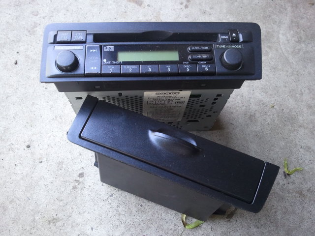

I have a factory Radio/CD Head unit if you want it. $40 shipped

I also have the little door compartment thingy that will be included with the head unit if he decides he wants it.

here's a look
